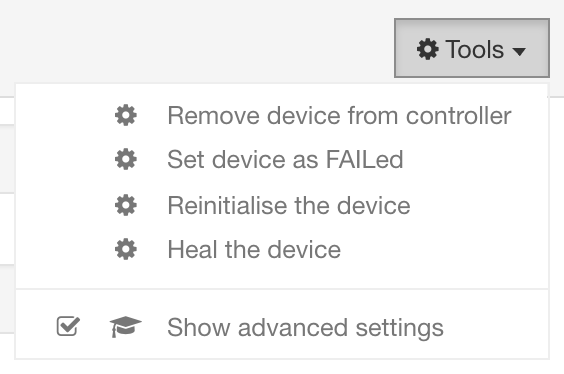

Maybe the thing to do is to use the latest binding that I just loaded an hour or so ago so we have a known starting point. The after initialisation has completed and everything is settled, use HABmin to reinitialise the device - this is in the menu in the top right corner once you select advanced mode.
Try this with one device that doesn’t work…
