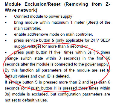

I just found this section in the docs:
So pressing the button 1 5 times within 3 seconds (in the first 60 seconds after repowering the device) should do the trick.
ok, I’ll try that. Now I understand what You mean :slight_smile: I mixed up concepts of channel and command class.
