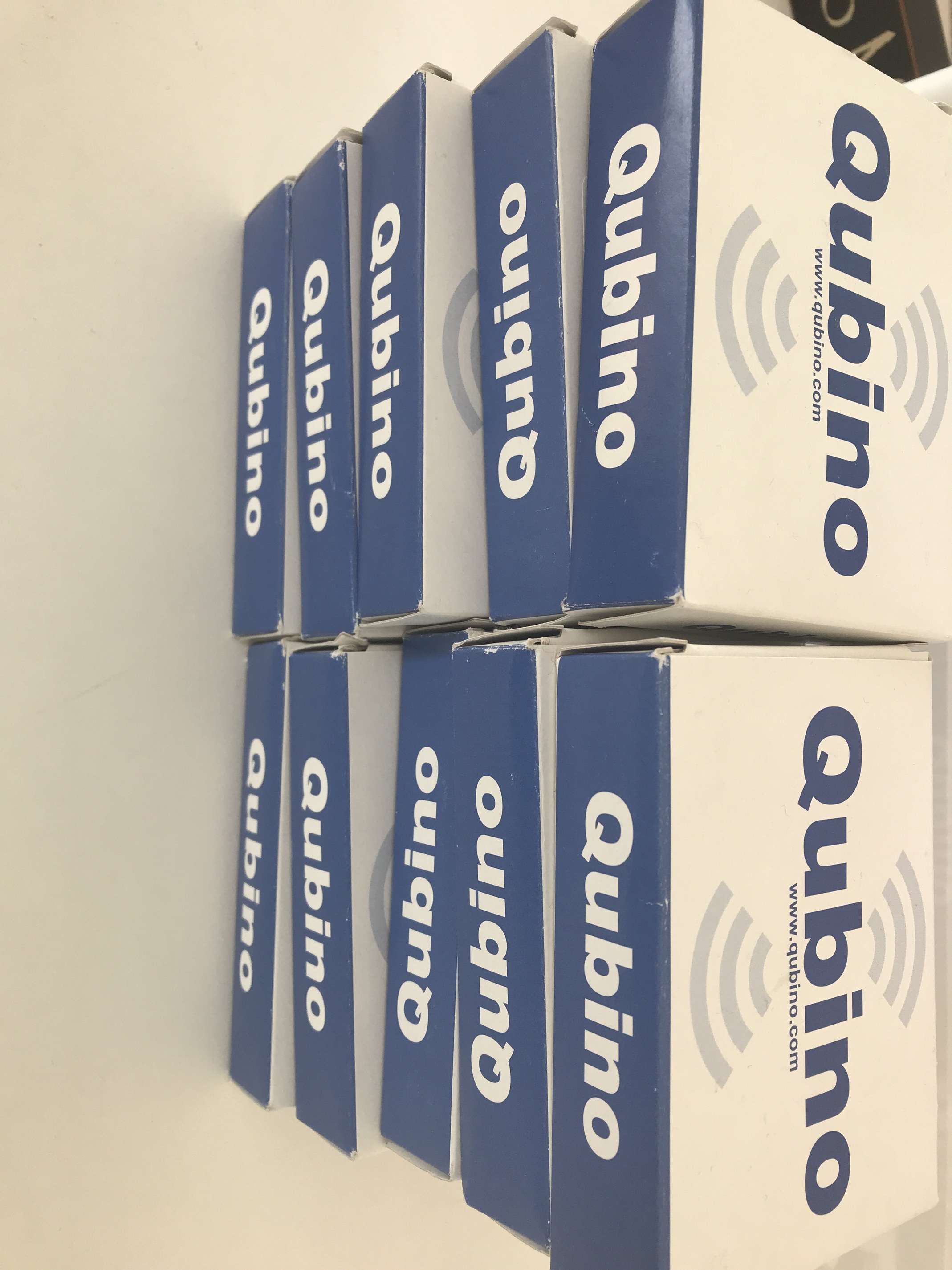

Then i had some new units newer used before.
Started with a flush1relay and it is working!
Next i tried a flushdimmer and that also worked!
What am i missing or what can i try?
Do you want any logs of this and what should they contain?
