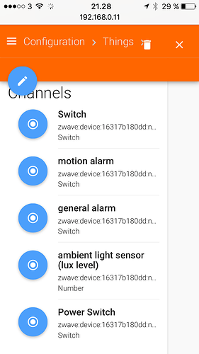

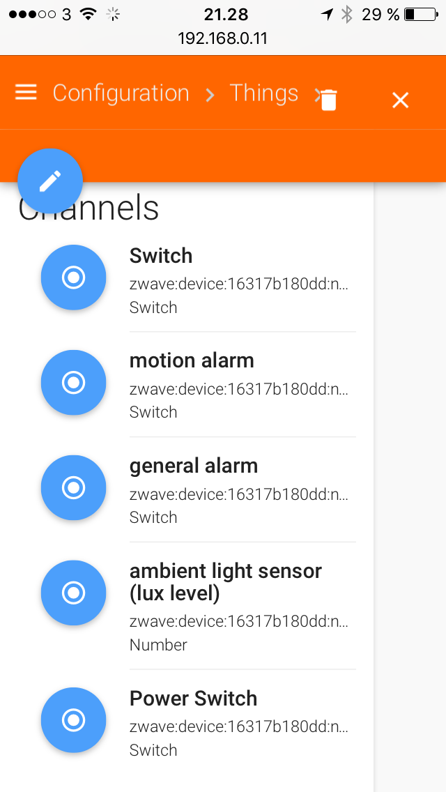

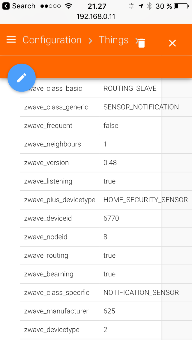

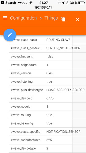

Running OH 2.2.0 with a Aeotec usb zwave stick. And trying to ADD Steinel 140 pir, gets added but it dosent seame to work correctly, like the lux sensor doesn’t show anything.
Any tricks or tips

The database entry is not correct, try editing the missing/wrong parameters.

I’ve updated the device to my best knowledge.
As soon as the changes have made it into the binding please report back.
It would be great to have some feedback on the individual channels to see if there are maybe too many included.
