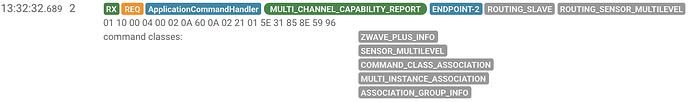

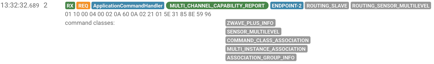

I’d like to understand warnings in the log that my simple openhab setup produces (OH2.1 with recent 2.2-snapshot z-wave binding) for the Steinel motion sensor:
2017-11-16 20:17:25.551 [WARN ] [class.ZWaveMultiInstanceCommandClass] - NODE 2: CommandClass APPLICATION_STATUS (0x22) not implemented by endpoint 2, fallback to main node.
Is it due to some still incorrect information in the device database? Any help greatly appreciated!
