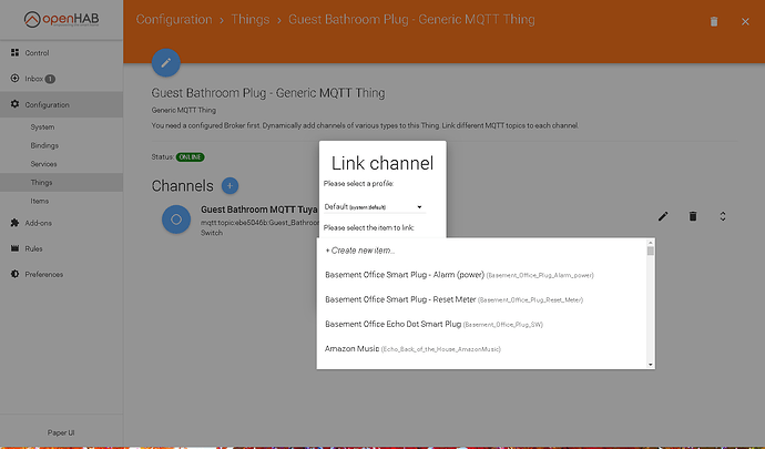

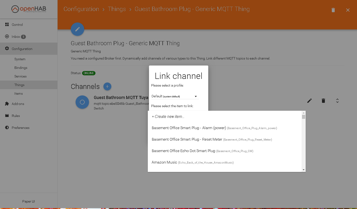

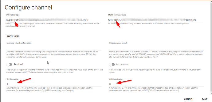

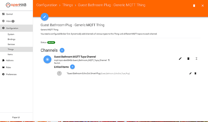

Here is a step by step pictorial on how to use the embedded-mqtt-broker to create a Generic MQTT Thing.

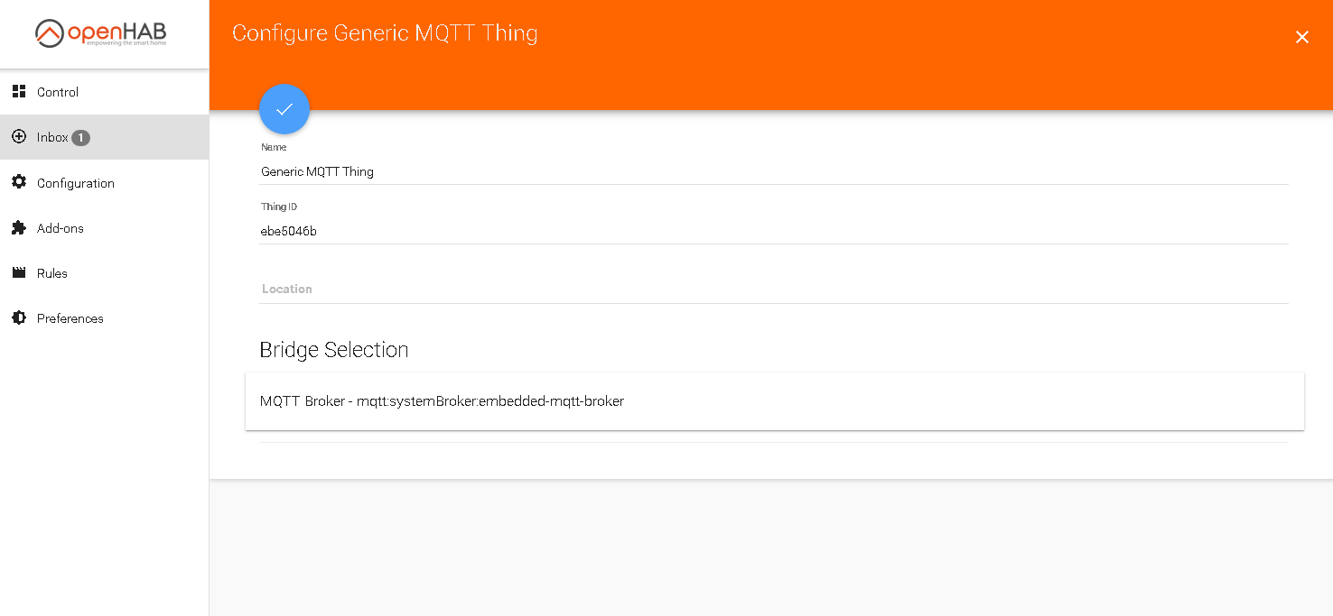

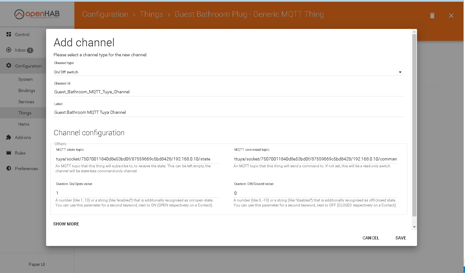

  1. Add a Generic MQTT Thing by choosing the inbox → + , select “MQTT Binding” to start searching but hit the “Add manually” then select “Generic MQTT Thing”

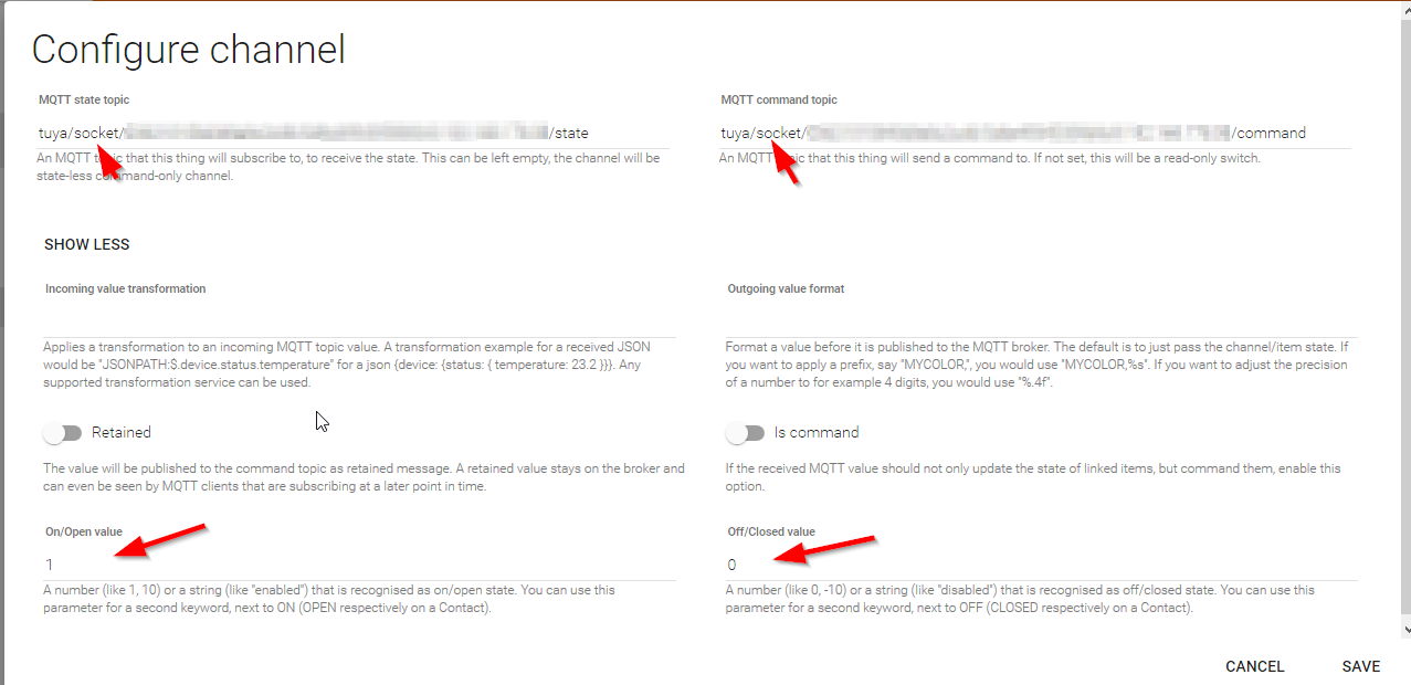

  1. Now add a channel to the Generic MQTT Thing. When you do this pick your channel_id_with_no_spaces.
NOTE: Double Check everything BEFORE you hit SAVE. Once you create the topic this way (via the UI) the only way to edit it is to delete it and recreate it.

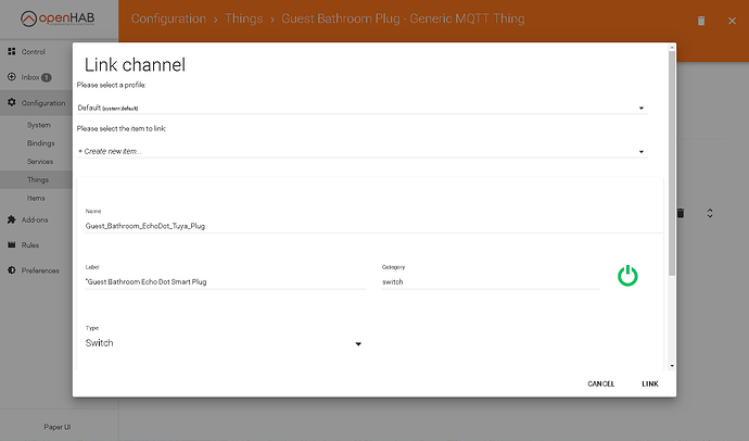

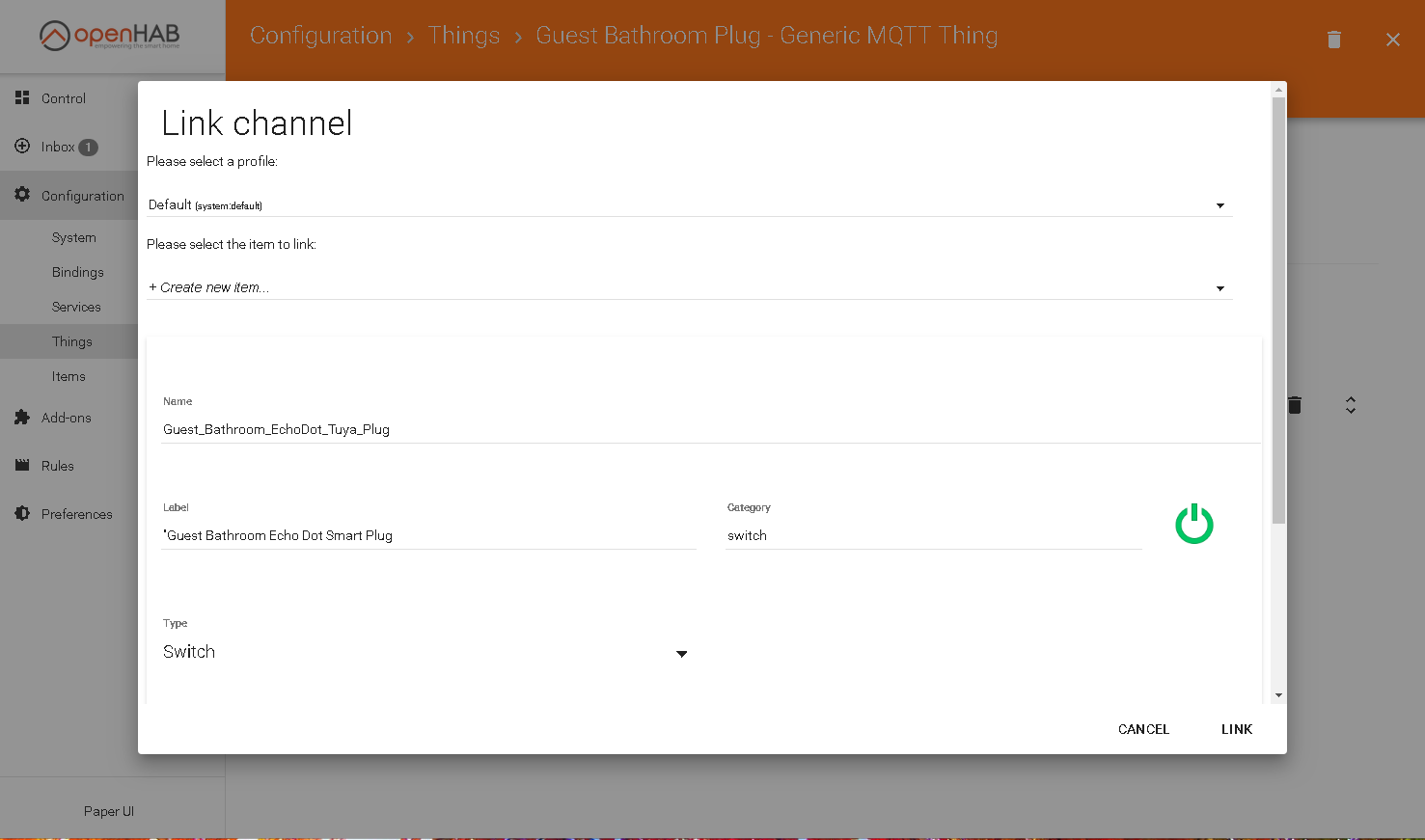

  1. Create the ITEM to Attach to the MQTT Topic channel:
    Choose “Create new item”.
  2. Link and ITEM to the TOPIC channel like this:

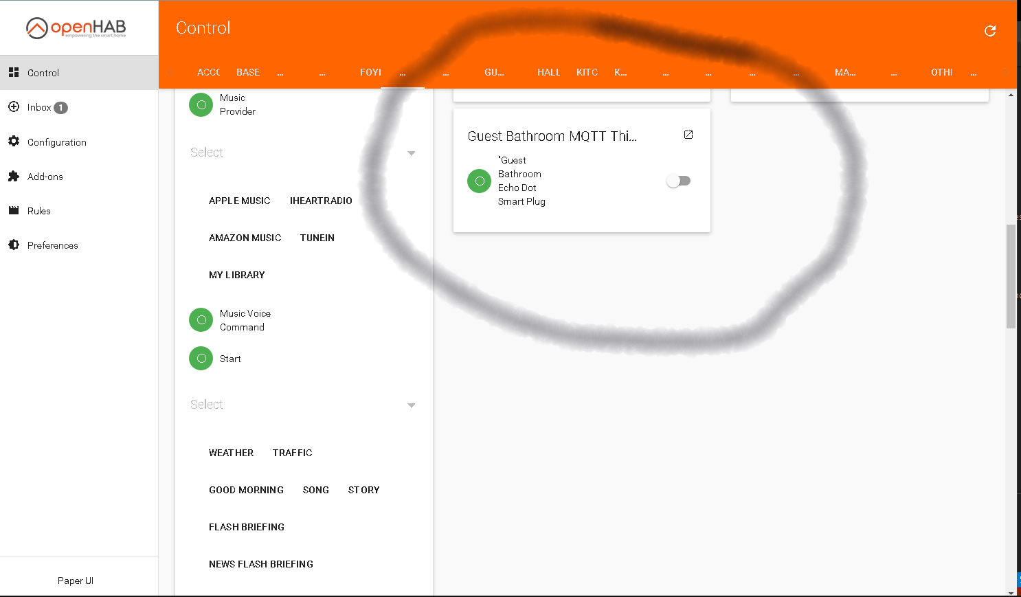

  3. Hit Link. Now you are setup to actually switch the plug/light “on” or “off” or just use its ITEM in a rule. So here is the final result:
  4. To access the plug in a rule, do this
To Turn the Plug ON use this in a rule:
             Guest_Bathroom_EchoDot_Tuya_Plug.sendCommand(ON)
To Turn the Plug OFF use this in a rule:
             Guest_Bathroom_EchoDot_Tuya_Plug.sendCommand(OFF)

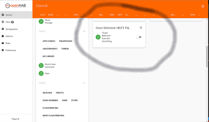

  1. (optional) You can also do a test by accessing Guest_Bathroom_EchoDot_Tuya_Plug (by its label or name “Guest Bathroom MQTT Thing”) through the “Control” and go to its assigned location and hit the switch!

“The big hurdle at the moment is getting the localkey for each device. Only developers get a secret key they can use it to set or get the private key for the device(it changes each time it’s set up)” In other words, if you have to change the setup on any tuya plug or light bulb, you will have to rediscover the “localkey” for the plug or light bulb!!
tuya/<"socket" or "lightbulb">/<Virtual-id>/<localkey>/<ip-address>/command
tuya/<"socket" or "lightbulb">/<Virtual-id>/<localkey>/<ip-address>/state

have you run tuya-cli to query which /dps/ topic that device uses? If you found your
with the anyproxy method then you had to install tuya-cli
This is the method of finding the keys, I was referring to:
https://github.com/codetheweb/tuyapi/blob/master/docs/SETUP.md
“oh_newbie”, I believed you used a different method. So here are the commands to install tuya-cli on a windows 10 machine (for linux use the right directory):
open a window Admin powershell at c:/openhab2/userdata/etc/scripts
>git clone git@github.com:TuyaAPI/cli
>cd cli
>npm install -g --save
Note: on linux or windows you want to install Tuya-cli GLOBALLY (-g flag on npm install line)
Here is the link to Tuya-cli setup page: https://github.com/TuyaAPI/cli
Run this tuya-cli command at any command prompt to see if it installed correctly (
Important
If tuya-cli throws an error under the following condition (#1 - somethimes, #2 always):
  1. try shutting down you OpenHAB2 server before using the tuya-cli command
  2. Also, BE-AWARE that while you are using the tuya-cli command DON’T have the Smart Life App (or which ever Tuya Smart App you use) OPEN while you are running the tuya-cli command on your server (tuya-cli will definitely through an unhanded error). If you must you the APP, access it before running the tuya-cli then make sure you exit the APP (don’t leave it running in the background on your phone)
tuya-cli help
or to find info on your plug:
tuya-cli get --id <Virtual-id> --key <localkey> --<ip-address> --all
example:
tuya-cli get --id 67833830cc50e3d4c9cf --key 559b607b2f0bac09 --ip 192.168.0.37 --all
tuya-cli produced the following output:
{ devId: '67833830cc50e3d4c9cf',
  dps: { '1': true, '7': true, '11': 0, '101': 0 } }
From that output I see I have two plugs on my unit that can be controlled.  The default, dps 1, can be controlled by using the MQTT state and command Topic below:
tuya/socket/67833830cc50e3d4c9cf/559b607b2f0bac09/192.168.0.37/state
tuya/socket/67833830cc50e3d4c9cf/559b607b2f0bac09/192.168.0.37/command, on="1", off="0"
I am presently testing this my self (I will let you know if this works) but I believe the second power port in the example can be controlled by the following MQTT state and command Topics:
tuya/socket/67833830cc50e3d4c9cf/559b607b2f0bac09/192.168.0.37/dps/7, on="true", off="false"
I know this works:
tuya-cli set --id 67833830cc50e3d4c9cf --key 559b607b2f0bac09 --ip 192.168.0.37 --dps 1 --set false
result: the power turns off on dps 1 (the main socket)
tuya-cli set --id 67833830cc50e3d4c9cf --key 559b607b2f0bac09 --ip 192.168.0.37 --dps 7 --set false
result the power on the USB port turns off
