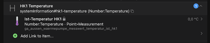

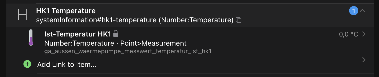

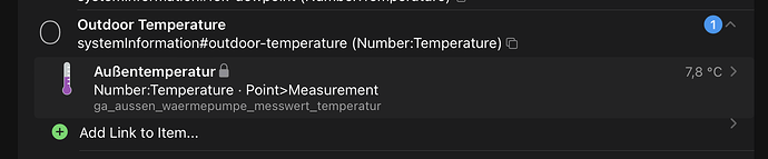

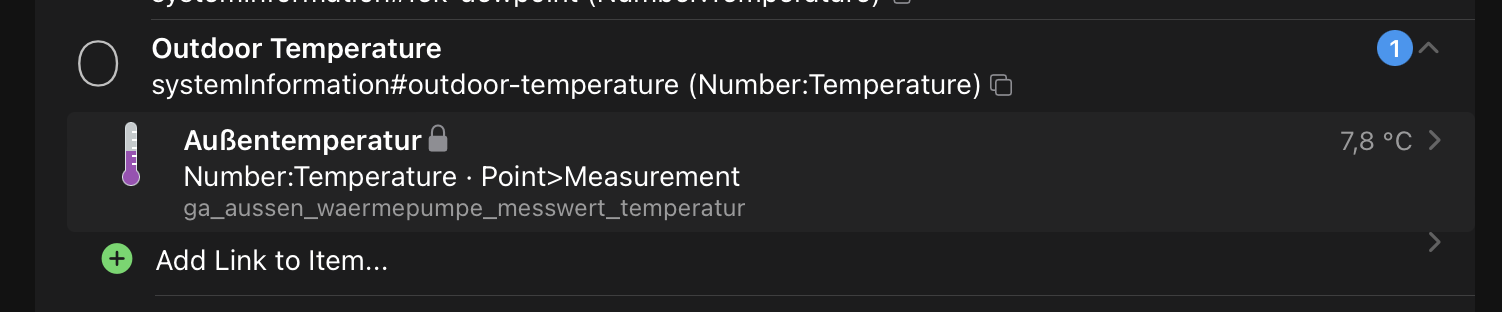

I attached two screenshots, I got the outdoor temperature, but not the hk1 temperature:

Have a look in docs - HK1 setpoint can be controlled with registers 509 (WP-M system and WPM 3) / 510 (WPM 3i) but also 1502 (comfort setpoint) / 1503 (eco setpoint).
