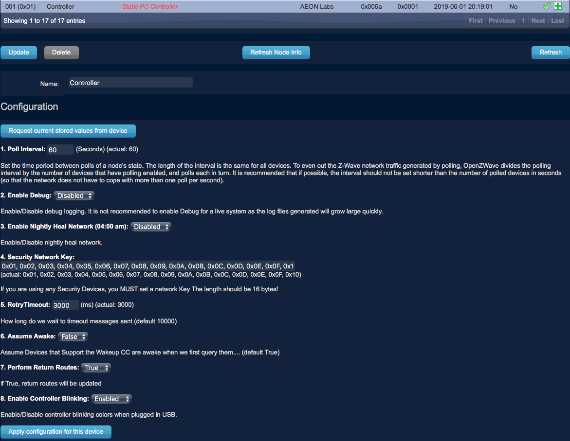

I have an Aeon Labs Gen5 USB stick as my Z-Wave controller. It works, and I have control of the devices on the Z-Wave network. I’d like to stop the color changing light on the controller from flashing through each color - it’s doing this constantly whenever it’s plugged in.
I think I just need to set a Z-Wave config parameter (81, which is in the DB https://www.cd-jackson.com/index.php/zwave/zwave-device-database/zwave-device-list/devicesummary/265 ), but I don’t see how I can do that with the items I have. I’ve tried this in both 2.3.0, and 2.4.0 nightly (I also followed the directions to remove and re-add the binding and devices on upgrading to 2.4.0).

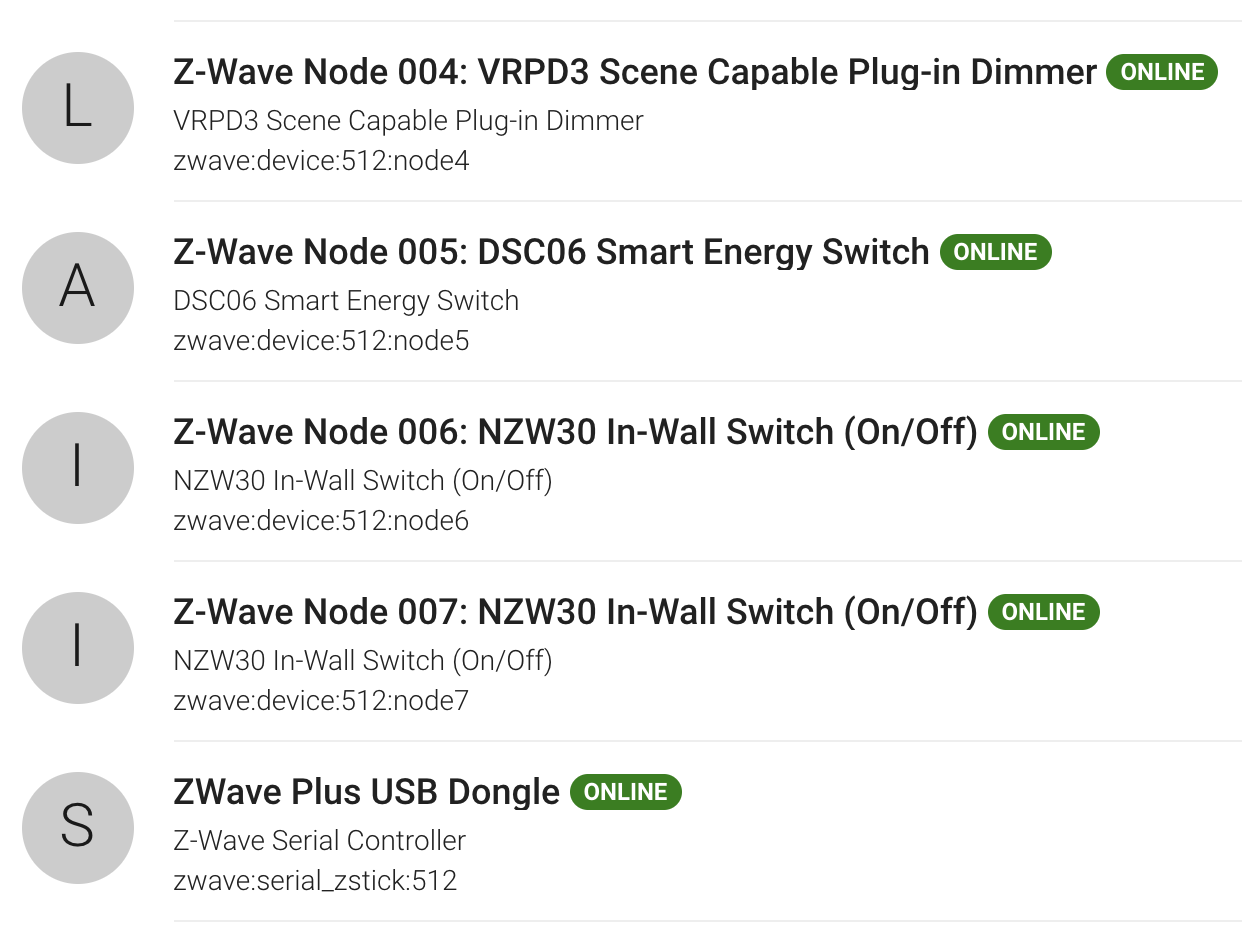

I do not see a “Thing” for node1, only a generic “ZWave Plus USB Dongle”, and that has no parameters available other than Z-Wave network configuration.
My devices start at node4 (there is no node 2 or 3 on my network, only 1,4,5,6,7)
