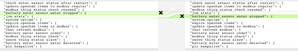

This does not match what I observe. Even without adding/deleting components, the top level ordering inside json can and will change according to my experience. (EDIT: this seems to stem to the use of ConcurrentHashMap in core which does not guarantee any “sensible” ordering?)
Here’s a snapshot of ordering between some trivial changes to rules (diff here omits changes inside the rules themselves for cleaner diff). You can see that there are now new rules added, nor any rules removed.
I have used grep '^ "' jsondb/automation_rules.json to filter top level keys of the root automation_rules.json json object.
I’m happy to also see if I could contribute more suitable serialization logic, such that ordering of entries is more rigid/suitable for diffing. But I wanted to see first if there are other ways to solve the problem
