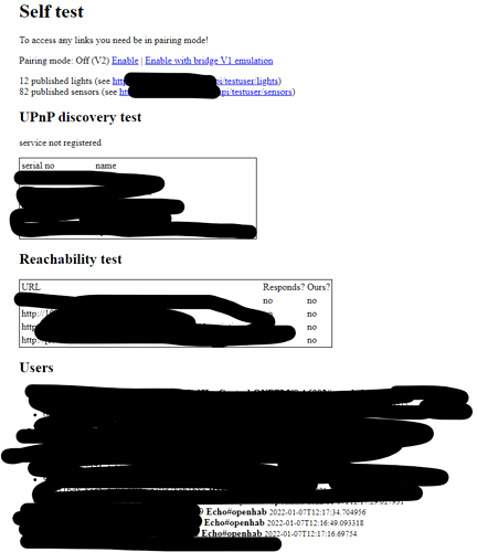

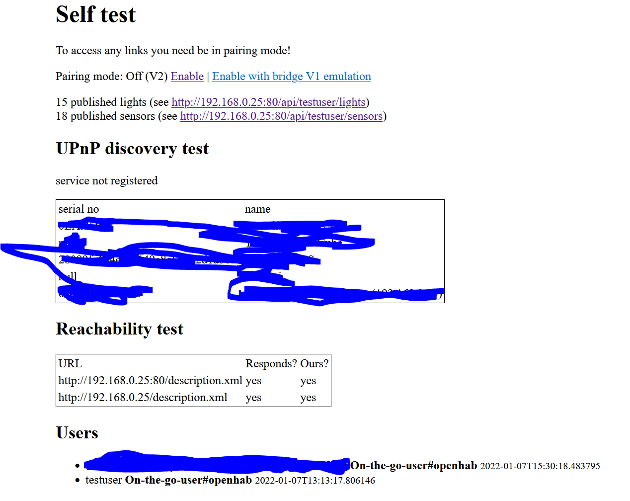

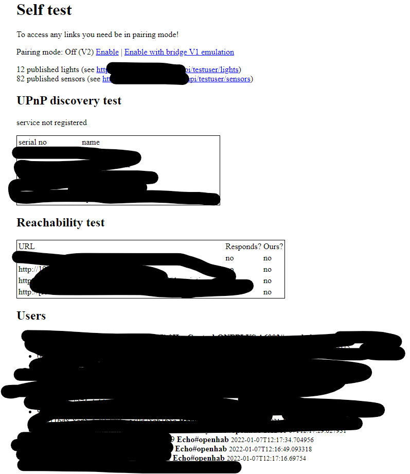

On the API status Page, I do not see any Echo devices. In the Hue section it just shows me all the published lights and sensors. The Amazon Account Binding shows all devices and I am also able to send commands to them.

The first “on-the-go-user” is probably your one echo that works.
Is your Hue Emulation running on port 80 and did you setup nginx to map the “/api” request as mentioned in the documentation? If not then my guess is that your newer devices are failing to pair with the Hue Emulation.
