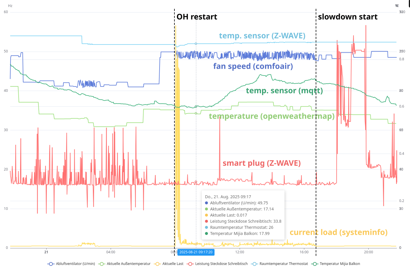

The following graph tries to show this using some differently effected items:
  • a temperature sensor connected to a Z-Wave thermostat - effected by slowdown (seems to not update at all anymore)
  • fan speed of comfoair ventilation system connected via RS232 - effected
  • a bluetooth sensor connected to OH via MQTT (broker not on OH device) - NOT effected
  • current temperature via OpenWeatherMap - effected
  • power consumption from a Z-Wave smart plug - NOT effected
  • current system load via systemInfo binding - effected
At the same time, it does not appear to be a general overload of the system, as I cannot detect any restrictions in responsiveness, either within openHAB or in the rest of the OS.
Any ideas what could cause this?
