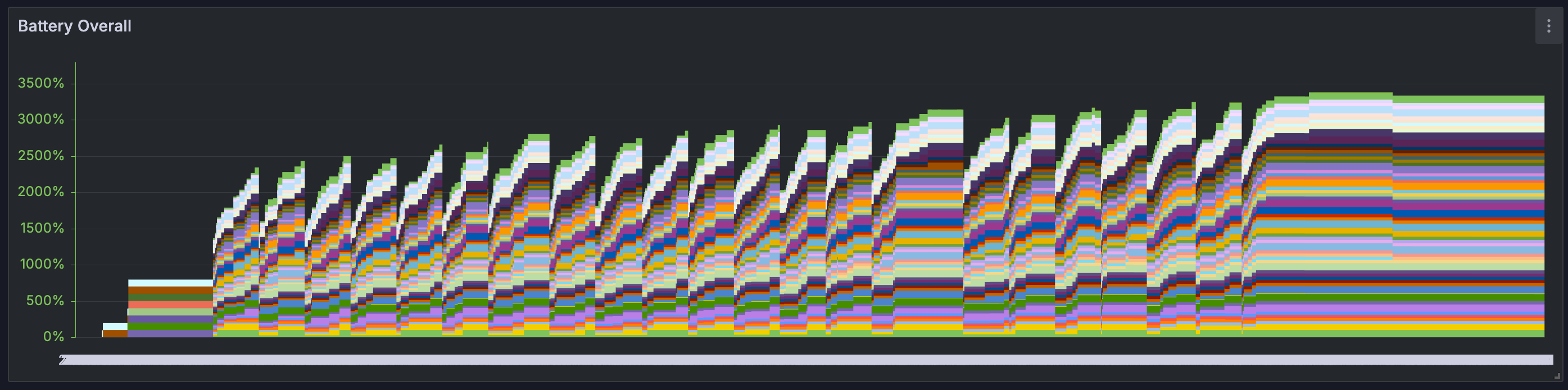

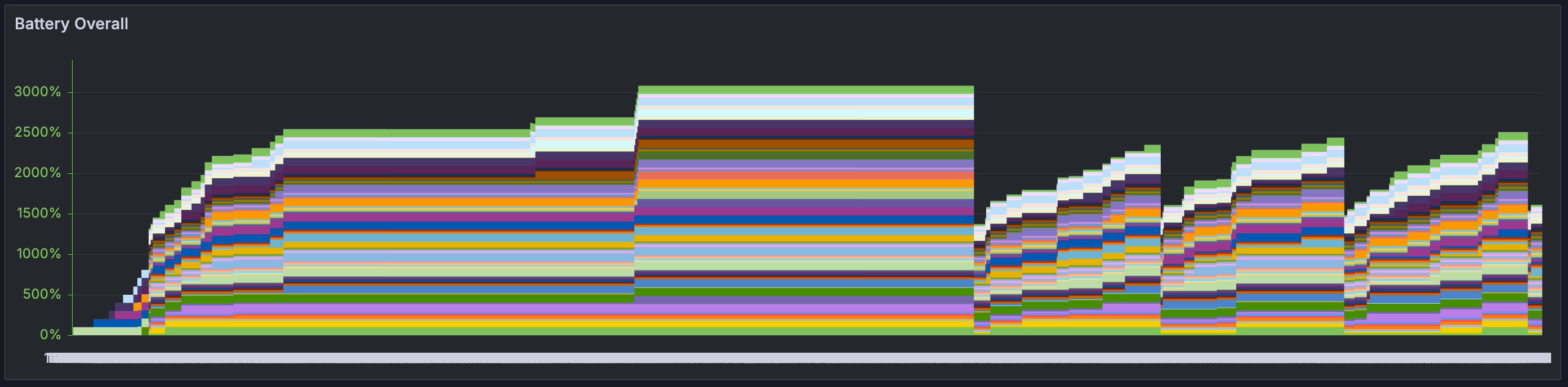

Looking at a graph, I see the rest coming every 2 hours, then the freq. changed to some 1h then less than that.
I am using git so I can see my history. So far, I did not spot what could be the cause of this “reset”. Morever my last chanegs are not related to battery levels…
