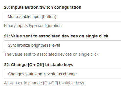

This device has a lot of config parameters, so make sure those are set properly, for example
(No. 20 of course only if you have a momentary switch connected)
Also make sure you have the Lifeline association group set to your controller.
I don’t think the configuration parameters are wrong because all was fine with OH 2.3. The upgrade can’t have updated the configuration parameters.

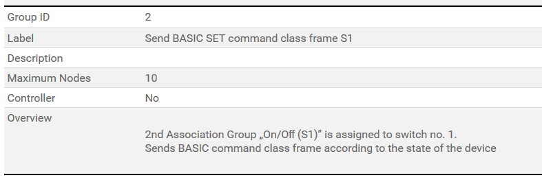

You must set association group 1 and 2 to Controller.
But the config parameters in the database could have changed and for example if you had a parameter which is now out of bounds you need to set it to a proper value.
I’m always using snapshots, at the moment #1407.
Group 2 does not go to the controller at all, that one is for the world outside of openHAB.
Well, if you associate it to the controller it does, and viola, local state changes appear in OH2 again.
See this post.
I don’t have Group 2 set and it works :smiley:
Yah, it used to work without for me as well, but it broke in one of my SNAPSHOT updates in late October early November. Never found out why. It also happened to an Nexa/Everspring on/off wall switch I have. One nice side effect after setting AG1 and AG2 of that device to Controller was, beside that it started working again, that local state changes was sent to OH2 instantaneously without the usual 2s delay :slight_smile:
Hmm, never saw any delays greater than a couple of milliseconds.
Are you using PaperUI to update parameters? If yes, bad idea, use HABmin …
This 2s delay is particular to that device when you use it as a scene controller. (well, minimal value is actual 3s)
Routing AG2 to the controller bypassed that, probably because, as you were saying, that AG>1 is normally intended for devices outside of OH.
I don’t know exactly what, but there is something strange going on with the Lifeline/AG1 association group…

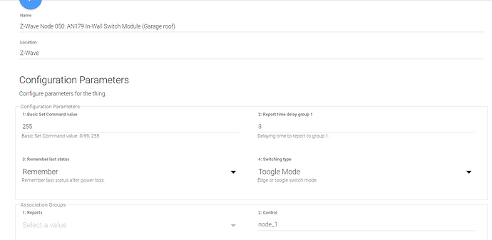

Hi All
I have this same issue on 2.5 snapshot, controller is set for Group 1. I get this predicted messaged also and my items now wont turn on when upgrading from 2.4 snapshot to 2.5 snapshot. All items were deleted and readded.
My Controllers are on, Lifeline set for AG1 and my things are also all online
Has something changed again in the way items are linked?

This post fixed my issues with the 2.4 Stable release Zwave binding :smiley: that darn pesky 1!!!
