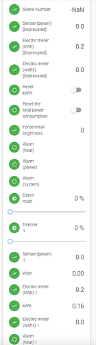

Strange numbers in kWh-meter display of NAS-WR01ZE

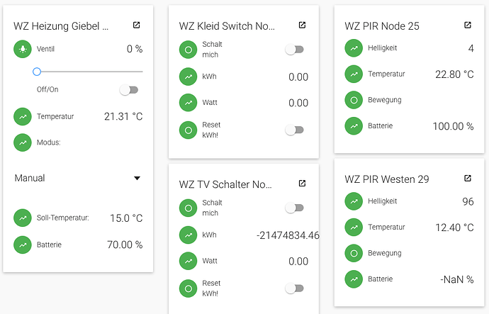

Just to close this out - the log processing showed the message was corrupted as received by the binding -:
2020-05-03 18:14:56.162 [DEBUG] [WaveSerialHandler$ZWaveReceiveThread] - Receive Message = 01 0C 00 04 00 19 06 31 05 03 0A 06 68 BB
The important bit is here -:
31 05 03 0A 06 68
31 05 is the command
03 is sensor type (luminance)
0A is scale=1, size=2
06 68 is the data = 1640 decimal / 10 (scale=1) = 164.0 = 1.64E+3
2020-05-03 18:14:56.165 [DEBUG] [ding.zwave.handler.ZWaveThingHandler] - NODE 25: Got a value event from Z-Wave network, endpoint=0, command class=COMMAND_CLASS_SENSOR_MULTILEVEL, value=1.64E+3

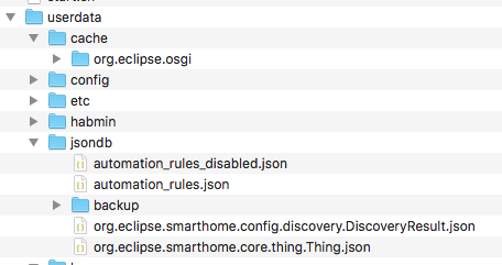

Just if another Mac-user reads this. The path to look at is /openhab xxx/userdata/jsondb/
But… I have still the old items, they are in the UI, and show up as persistence files. The deleted json files have not been re-created, so where is it coming from?
Ahh, the backup folder… :crazy_face:
After that the auto-items are gone, but in PaperUI all channels still showed, without values of course, except the ones defined in my .items file:
What now? Brave to death I’ve deleted the org.eclipse.osgi folder inside the cache folder.
Now the odd channels in PaperUI are gone, but all Labels are at their default value - the same as with auto-items:
Ahhh, once again, an OH-restart:
All fine now.

Hi, I have the same issue with negative energy values (based on firmware issue with flipping integer value) and solved it in my system (openHAB release 4.1.1) with a profile in the channel - item - link:
Maybe it will help someone else too …
