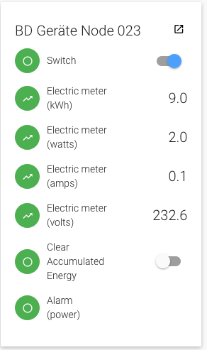

These show wrong numbers for the energy measurement:
  1. The number is way to high - a little bit more than twice from what the real used energy is.
    Is: 9.0 kWh
    Should be: 4.4 kWh

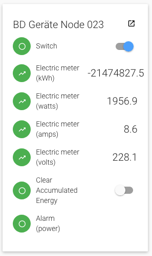

  2. The number toggles always from a decimal number to a strange number, like this:
    Toggles every 30 seconds (or so) when the washing machine is running…

It happens not random, but in a very regularly interval. When the washing machine runs, like 20 seconds the number is “good”, then 20 seconds “-2147…”.
So I think this is not a random data corruption, but some translation issue in OH of the number format, and it displays garbage when the value after the decimal is within X.
Regarding that the “good” value is a little bit twice over the real value: It is probably a side effect of wrong format conversion, but here I could believe another reason, since this equation matches suspicious well:
4.4kWh / 110V * 228V = 9.1 kWh
In Europe we have around 230V voltage…
So IF the device is dumb enough to measure only A, and multiplies this with fixed 110V, then that value would explain.

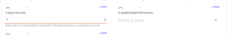

This is left, in the settings of Neo motion sensors - it doesn’t happen always:
In reality the value “-1” is 200, and the PIR Function IS actually enabled…
Is it the binding? I don’t know… There where a lot minus-values (or non-set value) issues, and since the kWh-meter is also minus-xxxxx, it was easy to suspect the binding.

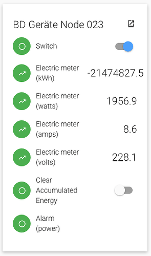

So, regarding the minus-values of the kWh meter, I’ve searched and found some interesting threads. For other users, as reference :wink: , it is a bug in the firmware of the Neo plugs, see links below.
Is it maybe possible the filter the nonsense-minus-values for this plug in the binding?

Normally -1 is 255 - this is normal and depends on the interpretation of the numbers from binary.
I’m a little confused. I think later in this post you say it’s not the binding and you refer to other systems. Have you looked at the logs? Or can you provide the logs?
No - this isn’t possible. You would need to do it through rules or something like that. The binding can’t really do this sort of thing as it would severely complicate the binding if we had to start coping with filtering strange values from devices - it’s just not viable.
Understandable (filtering → complexity).
Regarding -1 = 255: In the normal world it is not normal. :wink: How shall the user know?
