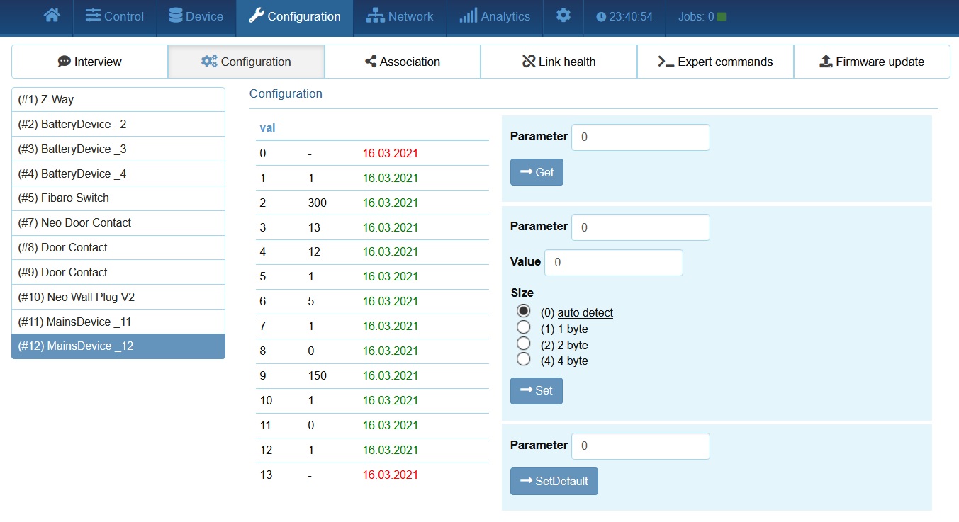

i found an issue with Paramters of Device 0200:1027 in Zwave Database. I bougth some time ago an Neo Coolcam Plug - ID 0003:xxxx and had no problems since. Last week my new Coolcam Plug - ID 0200:1027 arrived but did´nt work well. I investigated in this.
first Problem - Watthours shows strange numbers and wattmeter mostly to. Similar to this Post
second Problem - Order of Parameters 1 to 10 of zwave Device changed. I found this PDF(can´t remember where) and seams to match V2 default settings if i reset devices
Parameters - 0003:xxxx Plug
param1 - Meter reporting function Disable - 1Byte
param2 - Interval of meter reporting setting - 2Byte (default 300 in Screenshot)
param3 - Maximum output current setting - 1Byte
param4 - Current Alarm Value - 1Byte
param5 - LED indication Disable - 1Byte
param6 - Current Differential Setting - 1Byte in percent
param7 - Relay On/Off state Saved Disable - 1Byte
param8 - Timer Enable - 1Byte
param9 - Timing Length Setting - 2Byte (default 150 in Screenshot)
param10 - Button Switch Function Disable - 1Byte
zway params screenshot after device reset - seems to match
Parameters - 0200:1027 Plug “V2”
param1 - Relay On/Off state Saved Disable - 1Byte
param2 - Button Switch Function Disable - 1Byte
param3 - LED indication Disable - 1Byte
param4 - Timer Enable - 1Byte
param5 - Timing Length Setting - 2Byte (default 120s in Screenshot)
param6 - Meter reporting function Disable - 1Byte
param7 - Interval of meter reporting setting - 2Byte (default 300s in Screenshot)
param8 - Maximum output current setting - 1Byte
param9 - Current Differential Setting - 2Byte
param10 - Current Alarm Value - 1Byte (default 13A in Screenshot)
!also parameter 11 and 12 differs
!params9 changed from mA to % - % in relation to i do´nt know ?!? strange :wink: lower is more sensitive

It appears we may have a database conflict with that device. If you could find a pdf copy of the manual that has configuration parameters matching your it would be helpful.
Manual found here
Yes, the conflict is DeviceID 0200:1027 is already in database(screenshot) but 0003:xxxx are different in parameters.

That manual helps confirm my thoughts on the issue.
I will fix it so the next database export will be correct.
