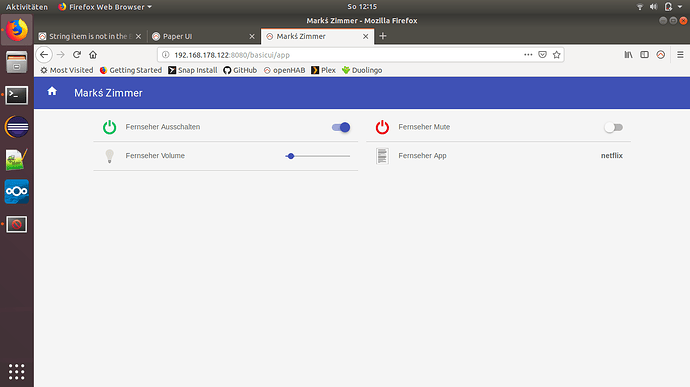

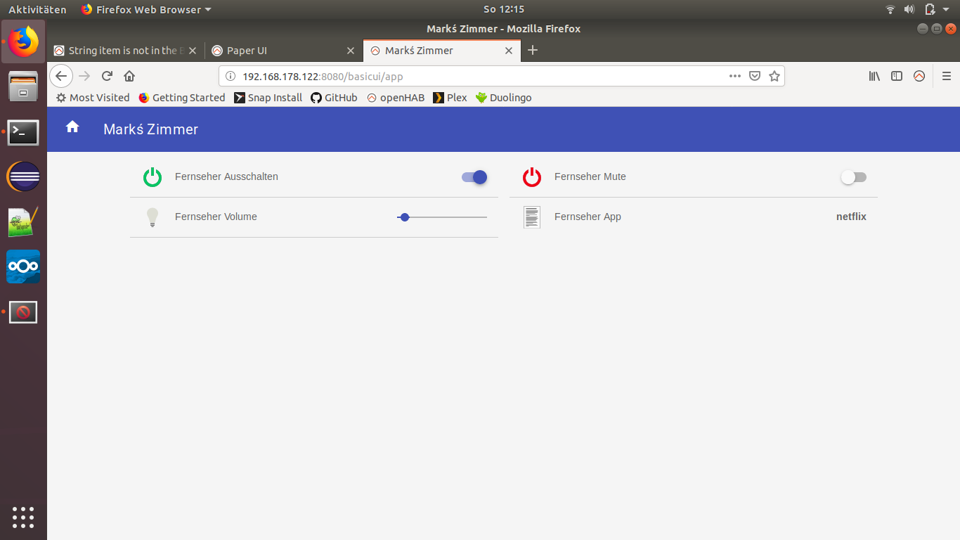

Ok cool! the item is in the Basic UI, but I can´t edit the Text.
