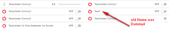

I made a little test with this Rule
rule "change item- name"
Item Dummy4 changed to ON
val vRadiator = radiator_valve_07_Temp.name.replace("_Temp","")
logInfo("change item- name","Name: {}", vRadiator)
val vTriggerItem = triggeringItem.name.replace("4","_new").replace("Dummy","Flummy")
logInfo("change item- name","Name: {}", vTriggerItem)
Dummy4.setLabel("Test4")
and used the syntax Scott advised (see Line next to last). And for me it works. But you have to know that your sitemap will nt change directly. You have to refresh it.

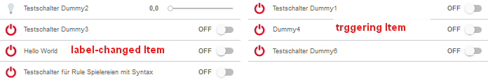

So looking on your problem, the DSL-Rule could look:
import org.eclipse.smarthome.model.script.ScriptServiceUtil
rule "change item- name1"
val vTriggerItem = triggeringItem.name.replace("4","5") // find Triggering item name (Dummy4)and change it as you want (Dummy5)
logInfo("change item- name1","Name: {}", vTriggerItem)
var GenericItem bmitem = ScriptServiceUtil.getItemRegistry.getItem(vTriggerItem) as GenericItem // now get the new Item as Generic
bmitem.setLabel("Hello World") // and change the label
logInfo("change item- name1","Name: {}", bmitem)
