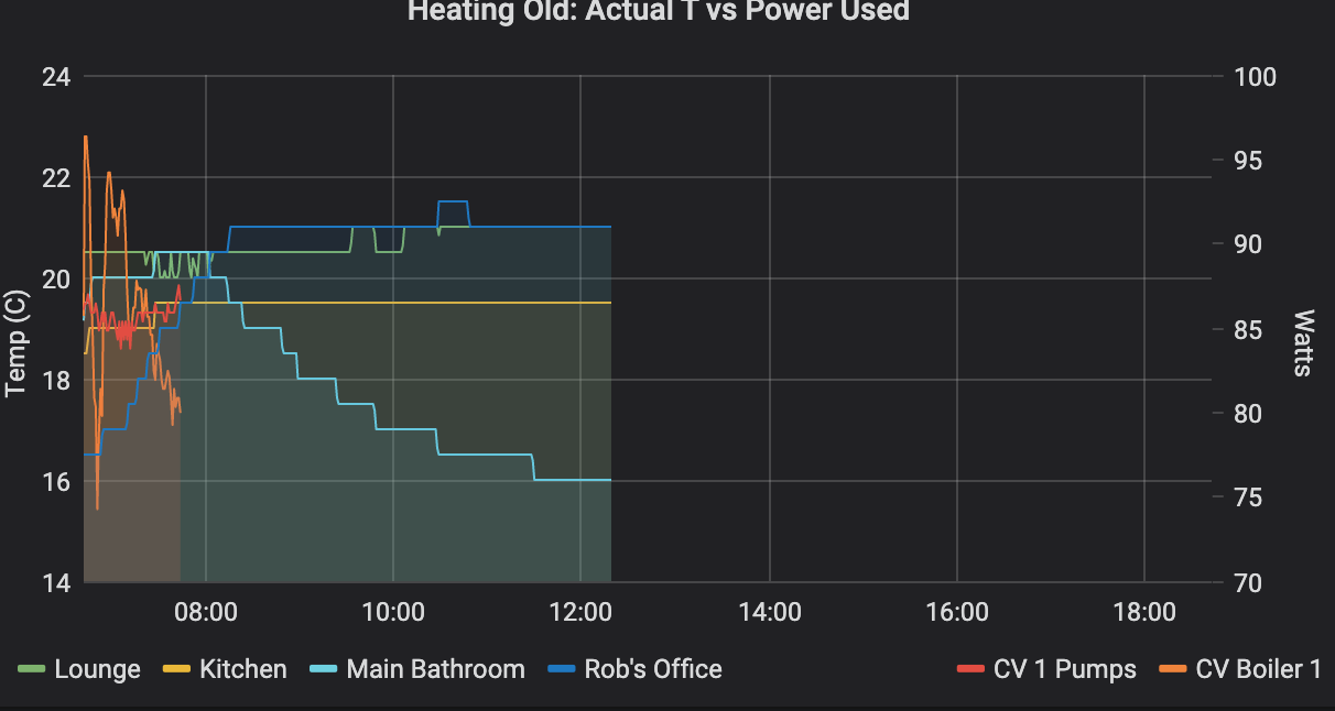

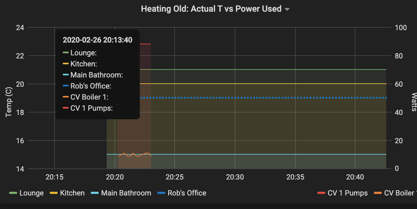

Sigh… still problems. Only some data is making it through to Grafana. Evohome data is flowing but the Plugwise data stopped - see graph. There are also some seriously corrupted looking messages from Plugwise in the logs. I guess it’s time to start from scratch. Don’t think I have the enthusiasm to start that this evening.

Do you see Items updating in events.log but not showing up in the chart? If not than the problem has to do with the Plugwise binding. If so then we need debug logging from the InfluxDB add-on.
Yes. Plugwise events are appearing in the events log and current status is appearing in the Paper UI. Data from Evohome items appears in Grafana, but no data from Plugwise items.
