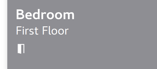

So I’ve been having fun defining the semantic model moving from OH2->3. I’ve defined a bunch of door with the semantic class Door and These show up in the location tab of the main home page when open as Icons

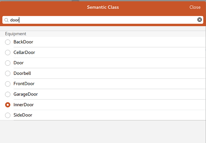

But if I redefine the inner doors as the semantic class InnerDoor they do not show up even though they extend the equipment door. Is this a bug or am I doing something wrong?

OK So I think there needs to be a lookup for InnerDoors (and all the other doors) here
There’s a parameter (“partial”) to include subclasses but for doors I wanted to treat garage doors separately, maybe it could be made better.
OK Thanks. I think I’d include garage doors as a door just the location would not be in my home but outside and I’d want to know if any are open but this is where opinion comes in. I have no problems with defining them all as doors.
