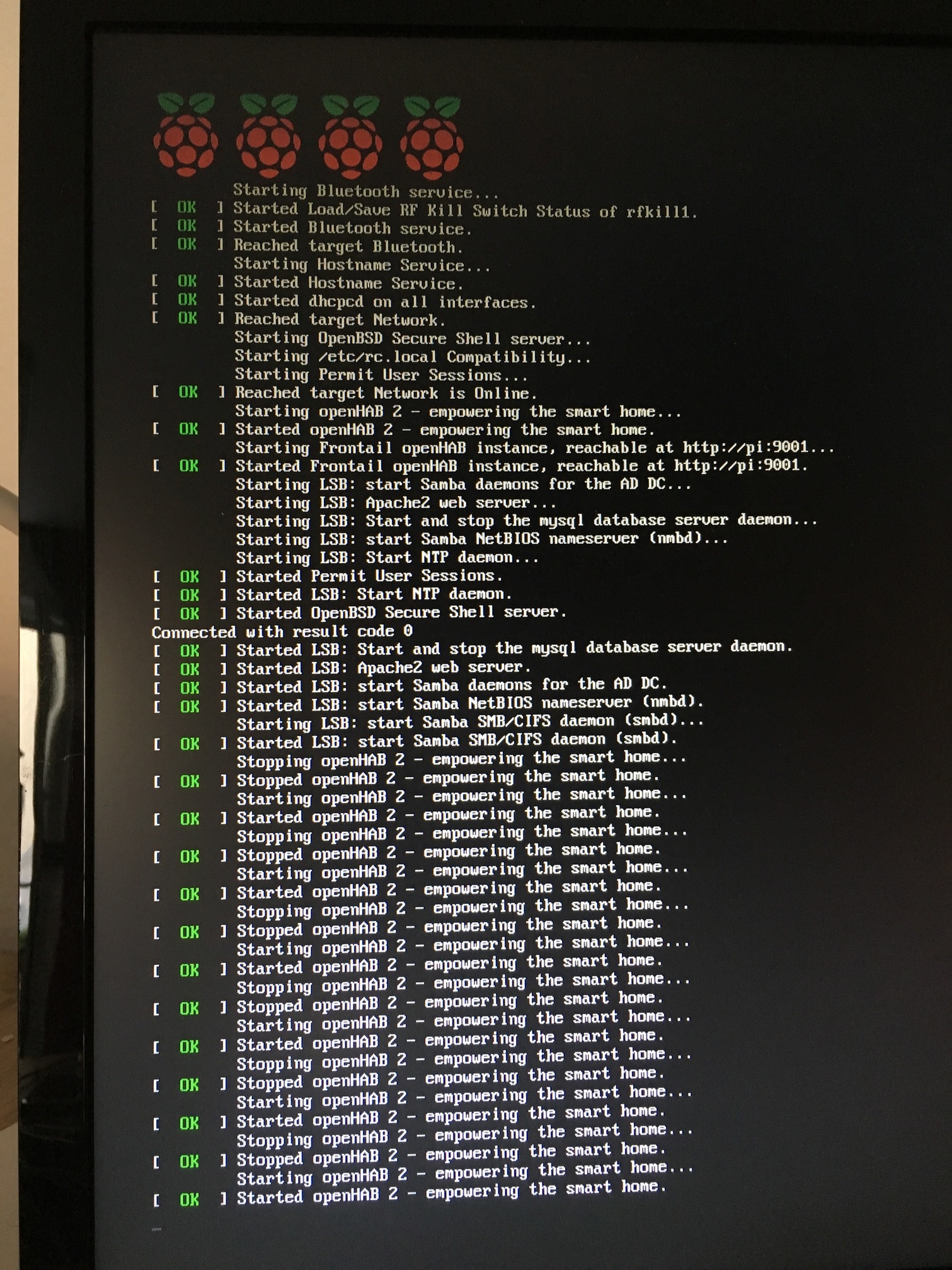

I am using a raspberry pi model 3 with openhab 2.2 snapshot and openhabian (8GB SD Intenso). Everything was working since last week: After a restart, my RPI doesn’t boot completely - there is a permanent loop which says:
I can wait for a very long time but nothing changes. A connection with SSH is not possible anymore. Unfortunately, I only have a backup from October and there a many many changes since then. I tried to clone the SD card and boot from the cloned one, but this doesn’t change the situation.

A clone is a byte for byte copy so that wouldn’t change anything.
There is something seriously wrong with your system. You will have to rebuild that SD card or restore your October backup. You might be able to access your files that have changed since then by mounting the SD card on a machine that can read it and copying the /etc/openhab2 folder and any other config folder you may have changed.
But ultimately either something changed that is preventing OH or your networking from starting or your SD card has worn out and you need to replace it.
