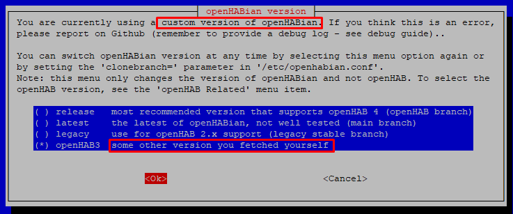

Liebe Gemeinde,
Leider ist mein Englisch nicht ausreichend um meiner Kritik Luft zu machen.
Nach einem sudo openhabian-config mal wieder ein abgeschossenes System mit der Meldung
2023-03-17 13:11:13.142 [ERROR] [ternal.service.BootFeaturesInstaller] - Error installing boot features
org.apache.felix.resolver.reason.ReasonException: Unable to resolve root: missing requirement [root] osgi.identity; osgi.identity=openhab-runtime-ui; type=karaf.feature; version=“[4.0.0.M1,4.0.0.M1]”; filter:=“(&(osgi.identity=openhab-runtime-ui)(type=karaf.feature)(version>=4.0.0.M1)(version<=4.0.0.M1))” [caused by: Unable to resolve openhab-runtime-ui/4.0.0.M1: missing requirement [openhab-runtime-ui/4.0.0.M1] osgi.identity; osgi.identity=org.openhab.ui.iconset.classic; type=osgi.bundle; version=“[4.0.0.M1,4.0.0.M1]”; resolution:=mandatory [caused by: Unable to resolve org.openhab.ui.iconset.classic/4.0.0.M1: missing requirement [org.openhab.ui.iconset.classic/4.0.0.M1] osgi.wiring.package; filter:=“(osgi.wiring.package=org.openhab.core.i18n)” [caused by: Unable to resolve org.openhab.core/4.0.0.M1: missing requirement [org.openhab.core/4.0.0.M1] osgi.ee; filter:=“(&(osgi.ee=JavaSE)(version=17))”]]]

Hello, I have suddenly the same Problem, but I’m not sure why…
I did today the usual update with openhabian-config and after that I got that problems running openhab, I got the same problem with apache as written above.
I’m on the OH3 stable branch:
but I have absolutely no Idea what it means with “custom version” or “some other version”, I always did updates through openhabian-config and I always was on this branch.
Before the Update today morning, I was on the version 3.4.2 but after the update, it seems I’m on the version 4.0.0:
grafik
How could that happen? How can I return back to latest 3.4.2?
I don’t think that I can run 4.0.0, as I have still Debian 10 (buster) and OpenJDK 17 is not able to install on this system:

It means you are not running the release version of openHABian. You are running some other branch. If you want to keep up with development of openHABian, I recommend sticking with “release”.
You are configured to run the latest release of OH. OH 4.0 was release this weekend. If you did not want to upgrade when OH releases new versions you would need to fix the version number. I don’t know if that can be done in openHABian which is always going to give you the latest version of whatever branch of OH you are running: release, testing, snapshot.
sudo apt-mark hold openhab-3.4.2
sudo apt upgrade
I think that’s how it’s listed. You should do an apt-cache search openhab if that doesn’t work.
That does seem to be the case for most.
It’s definitely right. It’s just 3.4.2 isn’t the latest release any more. It’s been replaced (three times over, the latest OH 3 is 3.4.4, and as I said OH 4.0.0 was release this weekend).
