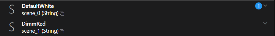

Currently the binding creates a separate channel for every scene like this:

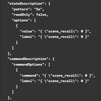

When I link an item to this channel the item gets the following state options:
To call a scene from a rule I have to set it like this:
ST_ZIGBEE_Group_Kitchen_Scene0.sendCommand("{ \"scene_recall\": 0 }")
Or like this:
ST_ZIGBEE_Group_Kitchen_Scene0.sendCommand(ST_ZIGBEE_Group_Kitchen_Scene0.getStateDescription().getOptions().get(0).getValue())

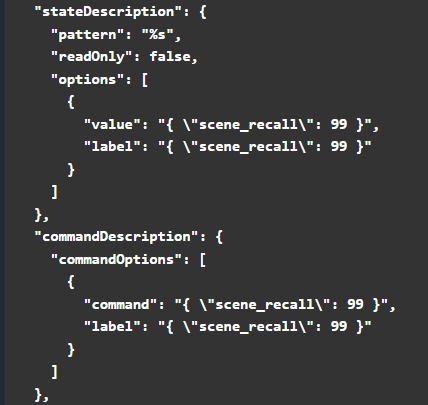

I’ve just tested this in OpenHab 4.3 with an item in .items file and one from the json database.
To test this I just checked the current state configuration of both items using the api explorer. Then I changed the value “{ "scene_recall": 1 }” to “{ "scene_recall": 99 }” directly with MQTT Explorer and checked both items again and they now had the new value:
This all happend even without an OpenHab restart or restarting the binding. After restarting zigbee2mqtt the state configuration also again automatically reverted back to “{ "scene_recall": 1 }”.

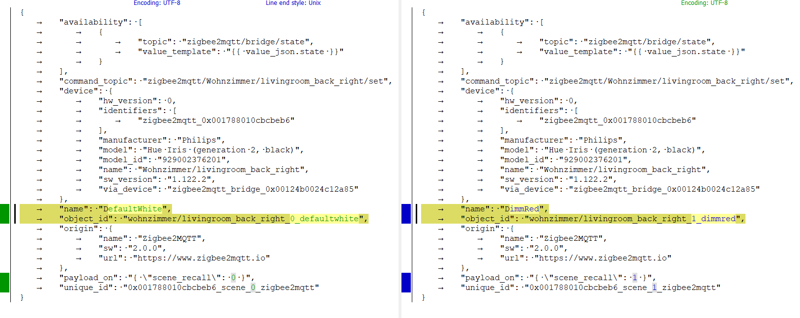

Regarding the scene topics. The command topic for the lamp scenes is always the same in zigbe2mqtt, just the name, object_id, payload_on and unique_id are different. Here is a diff of the scene_0 and scene_1 topic of one of my lamps:
Maybe the solution would be to group scenes that have the same command topic into one channel?
