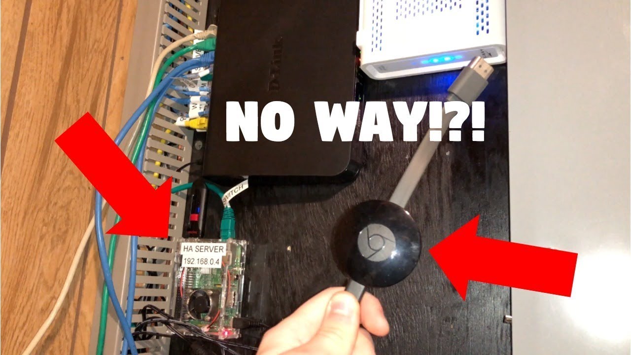

I’ve looked at how to write a Chromecast adapter before and unfortunately it didn’t look like there was an API for “jacking in” to an already running Chromecast stream and operating as a remote control for volume, fast-forward, etc, which is really unfortunate cause I use Chromecast all the time too.
It looked like the only way to do it was to write a dedicated app that streams to chromecast because then you have total control of the player which it looks like OpenHab can do:
So if you already use OpenHab to control your chromecasts then possibly I could write an adpter so Jaxcore Spin connects to OpenHab and operates as a master volume and remote control for play/pause/stop etc.
Yes I use the Chromecast binding which works like a charm. So your adaptor could piggy-back off it?
