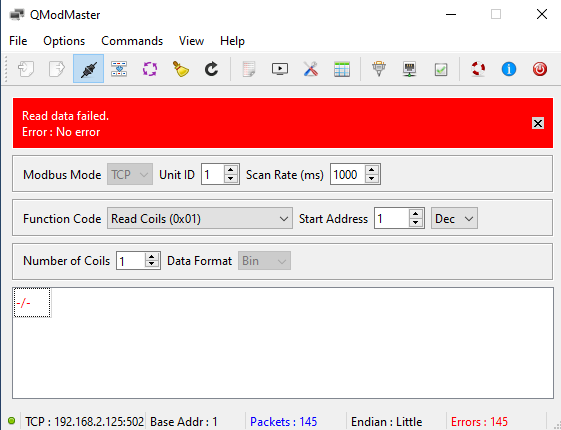

No success with QModMaster
:face_exhaling:

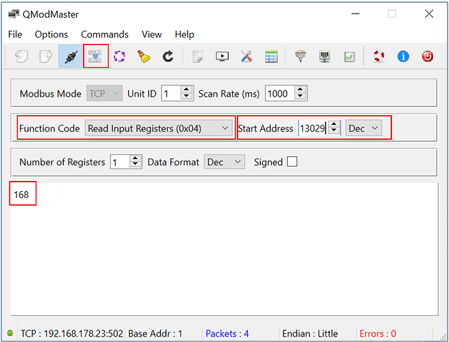

Sorry,
i did not explain what to do with this tool - as is has several options it is not self-explaining.
  • Connect via TCP to your sungrow inverter (as you did already)
  • Select Function Code Read Input Registers (0x04)
  • Select Start Address as listed above (13023, 13024, 13029)
  • Press Read/Write
  • The result is shown at the bottom, in my case i’ve read the self consumtion rate, which is 16,8%.
  • Sönke

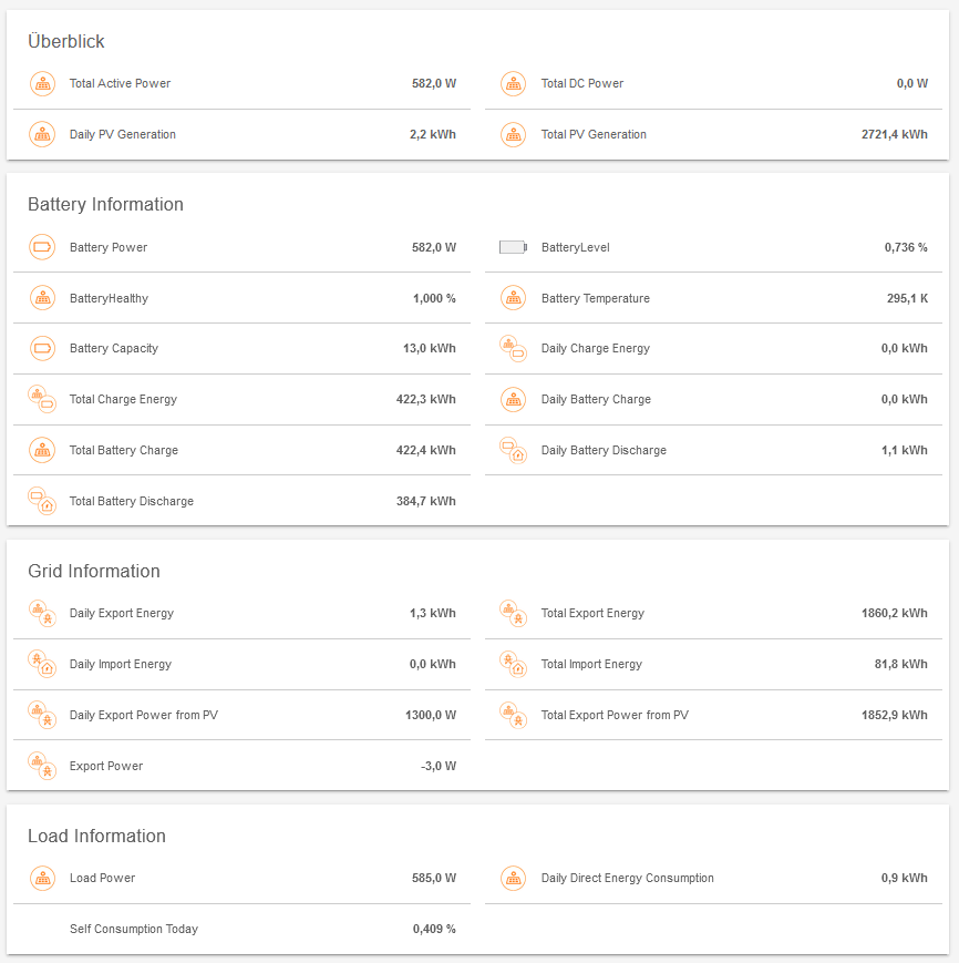

But there are some values I don’t understand i.e. the battery capacity
May be the item definition is not correct, especially the Number:Dimensionless items

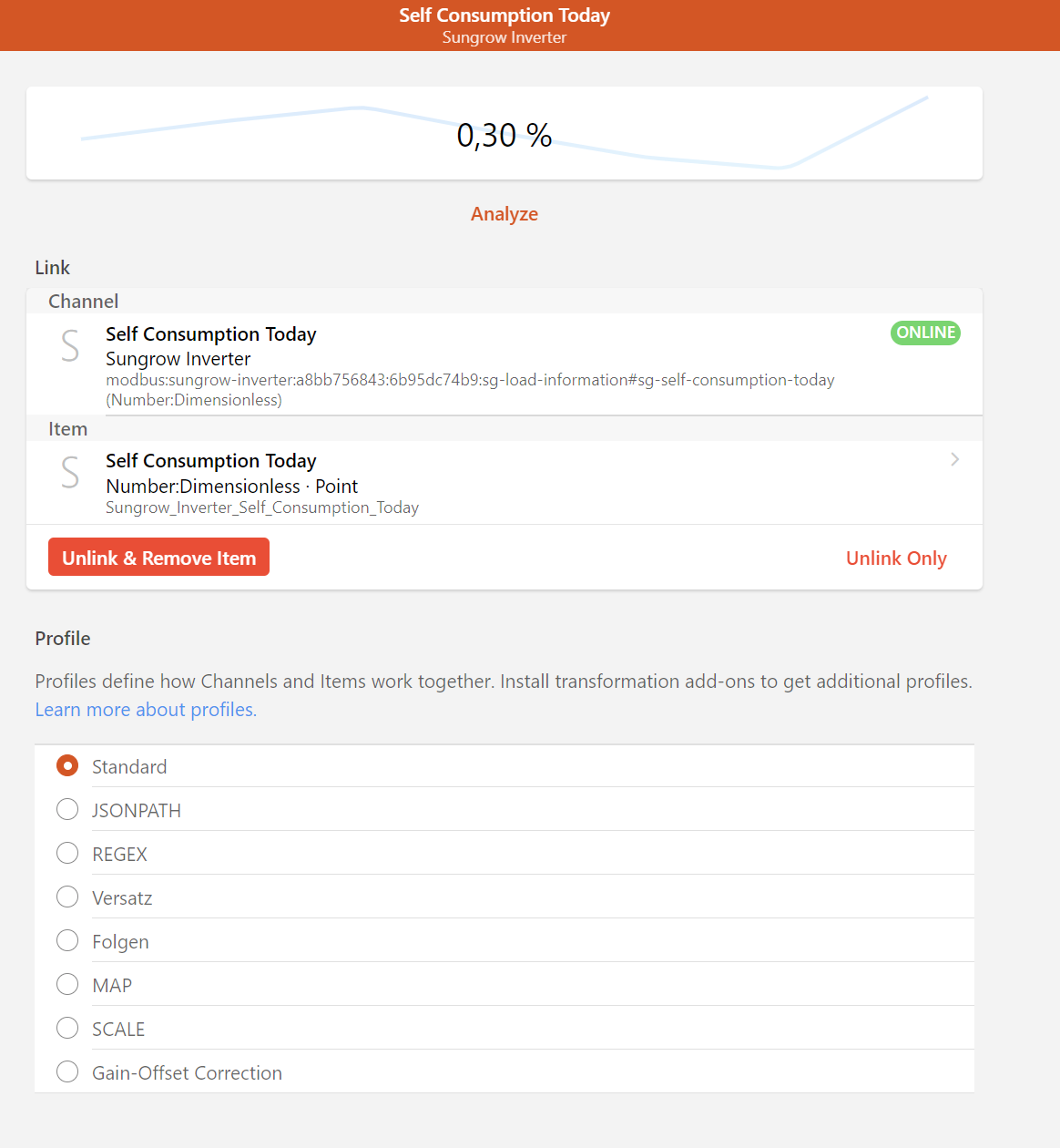

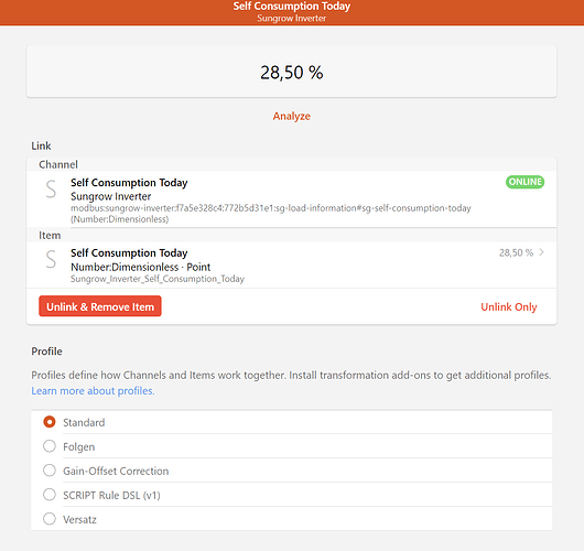

Number:Dimensionless        SG_LoadInfo_SelfConsumptionToday        "Self Consumption Today [%.3f %%]"                                                                              { channel="modbus:sungrow-inverter:b27d83c504:902b11b70f:sg-load-information#sg-self-consumption-today" }
Hey,
i’ve just checked the spec for battery capacity: there is actually a note, that it is only applicable to a set of types and yours (and mine) is not listed. So what would you say, leave it and add a comment in documentation or remove the channel?
The Number:Dimensionless-Channels (the three mentioned above with the percentage values) is very confusing. I had the same issue during implementation and changed the spec to Number:Dimensionless so that the percentage values are displayed correctly:
But when testing this in openHAB 3.x its wrong, i’ve to check if there was any change there and adjust the 3.x backport accordingly.
  • Sönke
My personal meaning is add a comment in the documentation, if possible with a link to the note.
I’m using OH 3.4.2, so the percent values are wrong, but hopefully OH 4 is coming soon (about 4 weeks) I will live with it :innocent:.

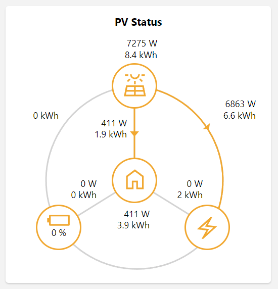

Hey,
i’ve created an openHAB widget that shows all important information about PV production and usage.
The widget uses the binding items by default and i tried to make it look like the original widget within the iSolarCloud app/web page.
In addition to the current power produced/consumed per source/target the widget also shows the total energy produced/consumed per target per day.
It works well in my installation - only battery is not testet yet (but my battery will be installed next week), so there might be an update afterwards.
