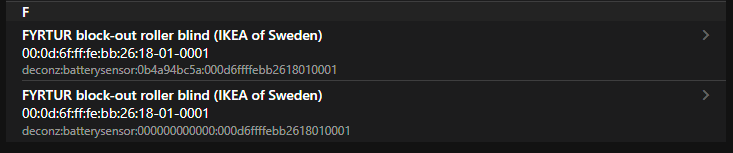

I’m having a bit of a problem.
I’m trying to migrate things from my smartthings hub to a openhabian og rpi4 with deconz and z-wave.
My fyrtur was working fine with smartthings
So my dconz thingy is up and running in openhab, but when trying to pair the roller shutter with openhab i only get two batterysensors in my inbox.
Tried a lot of pairings.. holding down 5 and 20 seconds and scanning for things with the binding..
Any suggestions?
