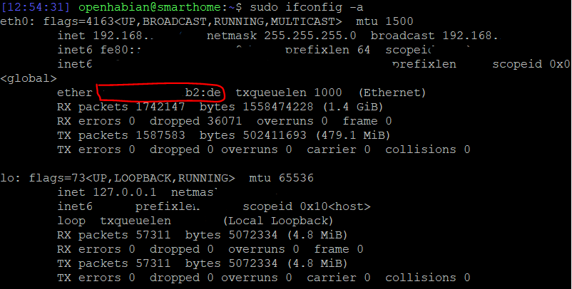

Okay! I downloaded an app called “Hue Essentials” but the App isn’t able to discover the bridge since I get an exception when trying to enable the bridge emulation:
2019-01-12 16:58:52.978 [ERROR] [org.openhab.io.hueemulation         ] - bundle org.openhab.io.hueemulation:2.4.0 (292)[org.openhab.io.hueemulation.internal.HueEmulationService(307)] : The modified method has thrown an exception
	at org.openhab.io.hueemulation.internal.Utils.getMAC(Utils.java:50) ~[?:?]
	at org.openhab.io.hueemulation.internal.HueEmulationService.restartDiscovery(HueEmulationService.java:413) ~[?:?]
	at org.openhab.io.hueemulation.internal.HueEmulationService.modified(HueEmulationService.java:257) ~[?:?]

Yes it doesn’t work in virtual machines or docker images if no Mac address is available on the main network interface. I think that is reported already as a bug, if not please do so :slight_smile:
I do set the timer in a rule that runs on system start.
Sorry, weirdly the complete wrong thread.
didn’t pay attention here, sorry!
I’m not running docker or a VM, the network interface is the RJ45 Port of my Raspberry.
Cutted out some things, but the ifconfig should be allright.
Its showing my MAC address of the network interface:
