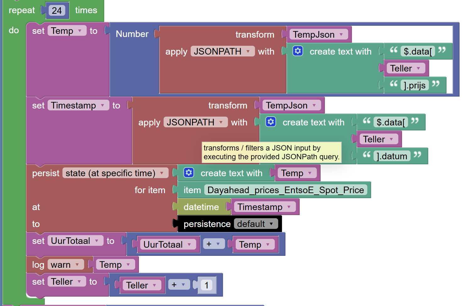

I use a rule to do this, so first a http api call to the provider and than I read 24 values incl their DateTime value out of the json result. With a Persist call you save the values as forecast.
