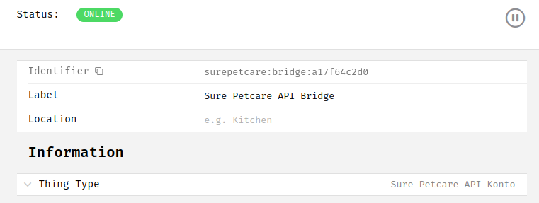

thank you for the quick fix!
on my system the provided .jar solves the connection issue (oh 3.4.4):

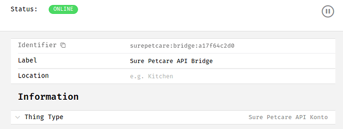

That worked!! Thanks for quick turnaround.

Thank you so much! I updated my system and then had no idea where the cat was :slight_smile: Removed the binding, added the JAR manually to Addons, re-booted and everything has come back. Many thanks!
