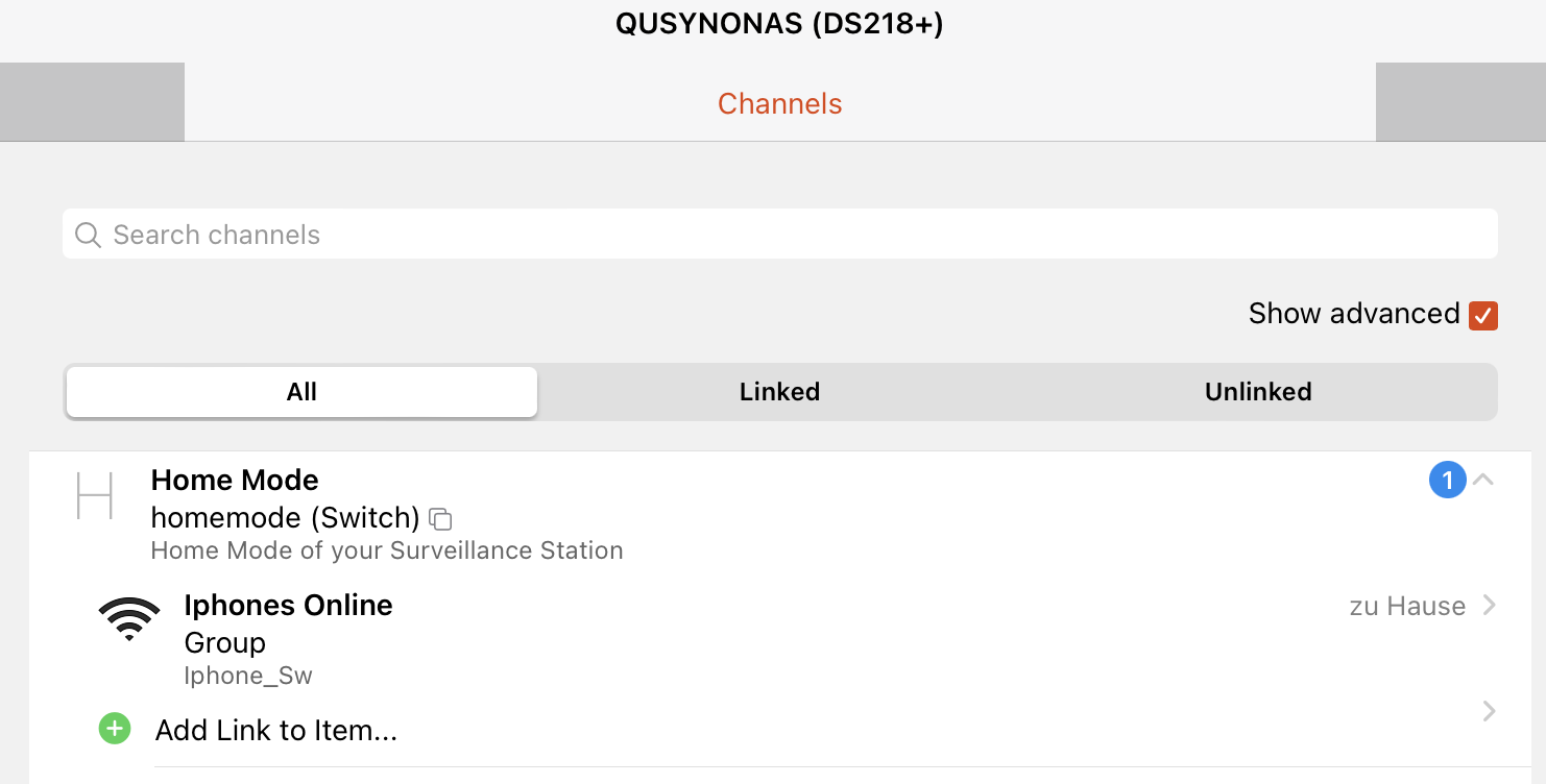

i am sure you get this solved with your http request but I want to give you another direction which is using the Synology Diskstation Binding. There you have the Home Mode Channel for the Surveillance Station which you can comfortably work with in rules if you want and you don’t need to work with your http string to activate / deactivate your home switch.
Hi Muelli, thanks a lot for the hint! That made my day!
I’ve already tried with the Synolody Binding but I couldn’t find the Home Mode Channel as channel list was empty so I haven’t tried to clieck on “Show Advanced”
