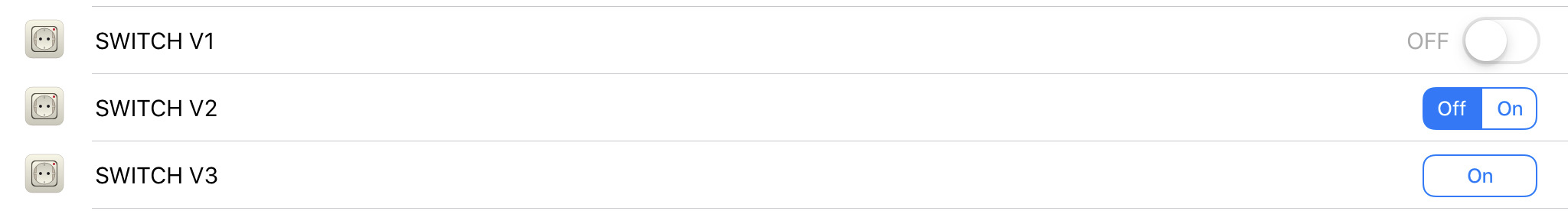

I have the following items defined in my sitemap which all are displaying the state of the same switch:
	Switch	item=EMD_07_05			label="SWITCH V1"
	Switch	item=EMD_07_05			label="SWITCH V2 []"   mappings=[OFF="Off",ON="On"]
	Switch	item=EMD_07_05			label="SWITCH V3 []"   mappings=[ON="On"]

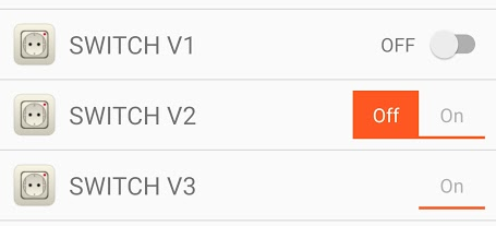

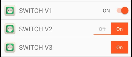

All three items are displayed correctly in off and on state within the Andoid app:

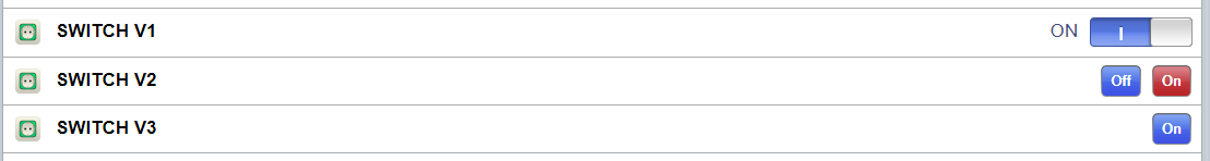

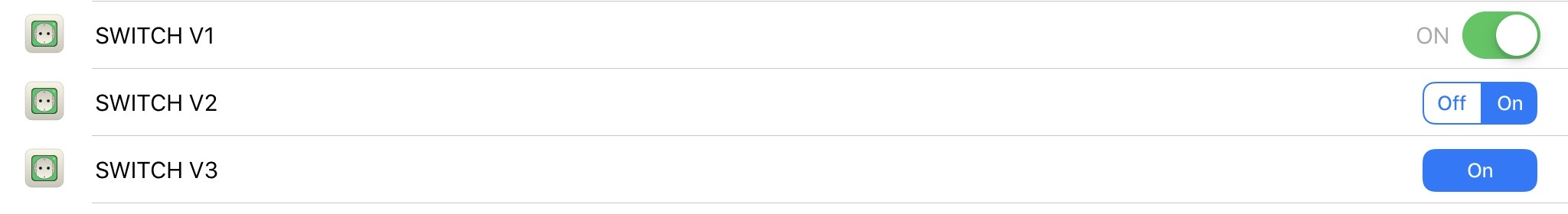

Same on iOS iPad:

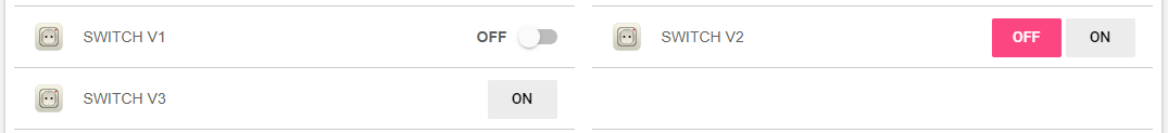

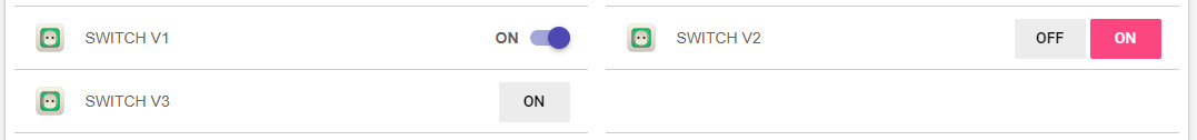

But BasicUI and ClassicUI are making an error when displaying version 3 of the switch (with only a mapping for “ON”):
Here BasicUI:
And the same for ClassicUI:

I can switch on the switch by clicking on “ON”, but “ON” will never get highlighted.

It used to work like you expected in the old version of the Ios App. You could use a switch item and show it as a single mapped button that would be shown as on if the switch had the mapped state. But one of the app developers told me that that actually was the bug.

 I just updated my iOS version and now it changed the behaviour
