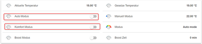

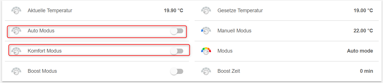

i have a few heating thermostat, and added them to my openhab configuration.
For each of the items I can activate the Komfort Mode or the Auto Mode. If I do that, the switch work as a button. Short activaten and the auto deactivation of the button.
Now I want do create a button to activate all heating thermostat with one button. But when I add a button to the items the switches of all heating thermostat hold the state active. I have current no idea to solve this. Have anyone current implement this usecase?

When I trigger the mode on one single heating thermostat, I press the button an the active state goes fast to deactivate. If I trigger this with an separate switch, the state will stays in active.
