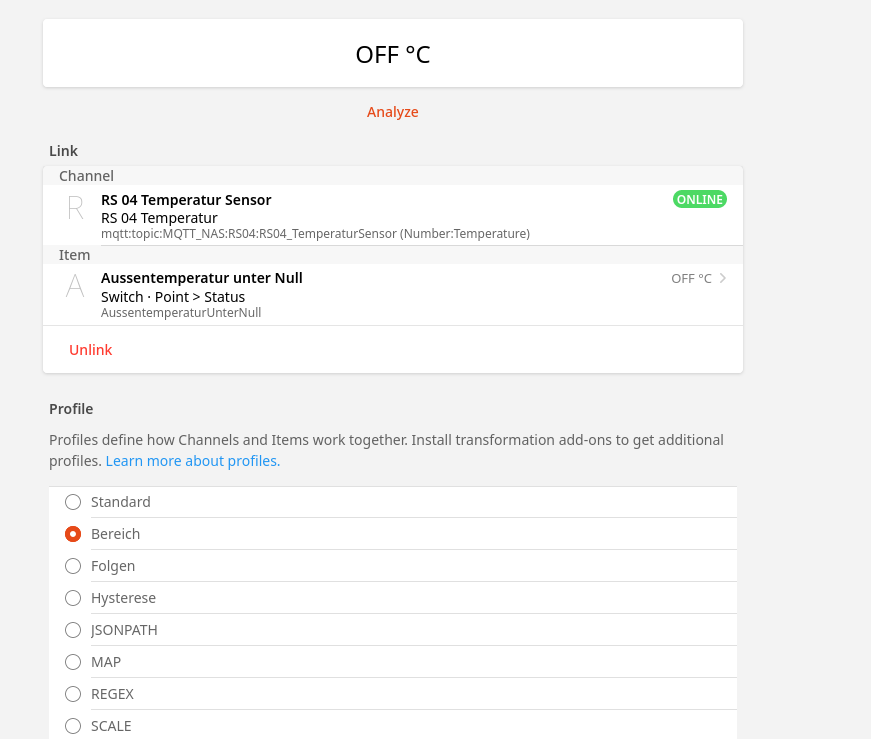

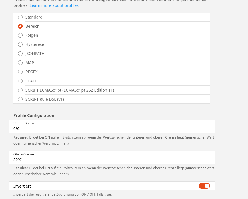

I have a temperature sensor, and used a rule to set an item if temp. is below 0°C, but due to last comments in a thread here, I tried the range profile to set this item.
- if you select the numeric channel and want to link an existing switch item (with range profile later on) it’s not been shown, only numeric items.
- so you have to create a new switch item.

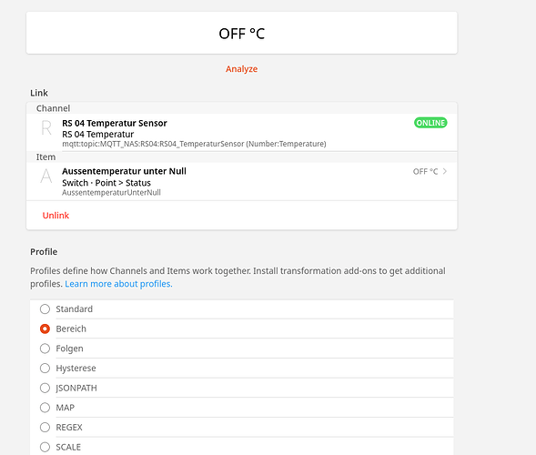

- when all parameters are set, the state of the switch item is ‘OFF °C’ or ‘ON °C’
How can I get rid of ‘°C’
edit: it‘s ok with Current or Voltage items, only Temperature is wrong, might be a bug
