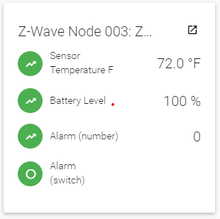

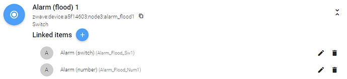

I have a Zwave water sensor added to OpenHAB (Aeotec Water Sensor 6) and is online. I have the items configured manually and temperature and battery are being reported. As for the alarm channels, there’s the problem. If I configure the alarm channel as a Number, it reliably reports 0 or 1 based on the presence of water, which is great. However, the Thing shows that the alarm channel should be configured as a Switch. This is the part that doesn’t work. If I configure the Item as a switch, the alarm never gets updated.
Here’s the funny part – in fact, the switch did appear briefly in Paper UI and was getting updated, but only briefly. It disappeared shortly afterwards for no apparent reason. I could not link the disappearance to anything I changed. A restart of the Raspberry Pi once resulted in the switch reappearing briefly, but another restart had no effect. Very frustrating!

Here are my items. Note that I configured two items for the Alarm, one as a number and one as a switch, for diagnostic purposes. Only the number shows up and gets updated.

Here’s what I see in Paper UI:
Here’s what the sensor Thing says for the channel:

I created a sitemap for the temperature, battery and flood switch, and the sitemap is now showing a toggle switch that updates when water is detected. Alexa also discovered the switch, so perhaps all is well. However, I’m wondering why the flood sensor switch won’t show up in Paper UI? Is it just a bug in the UI?

I’m guessing it’s because the item is a “switch”, but you can’t turn that switch on or off from openHAB. So, PaperUI doesn’t display the switch.
That’s because PaperUI was never fully developed (and I believe will be retired in the upcoming OH 3). It’s never good to draw any conclusions from what it shows in the Control page. Don’t worry, you’re not the first one to get caught by this.
So yeah, all is well if it’s showing up properly in your sitemap. :wink:
