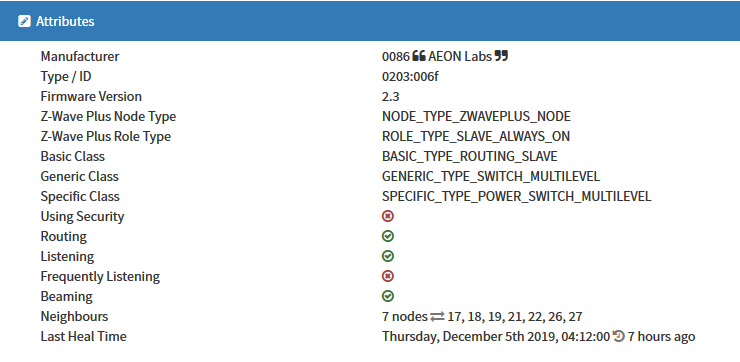

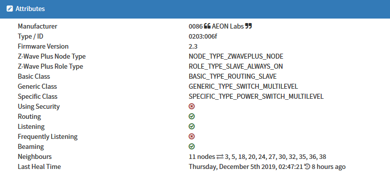

Working version ZW111 Aeotec Nano Dimmer (this version has worked since binding back in October 2019)
Not working version ZW111 Aeotec Nano Dimmer (this device was not known to ZWave prior to the update done in build #846)

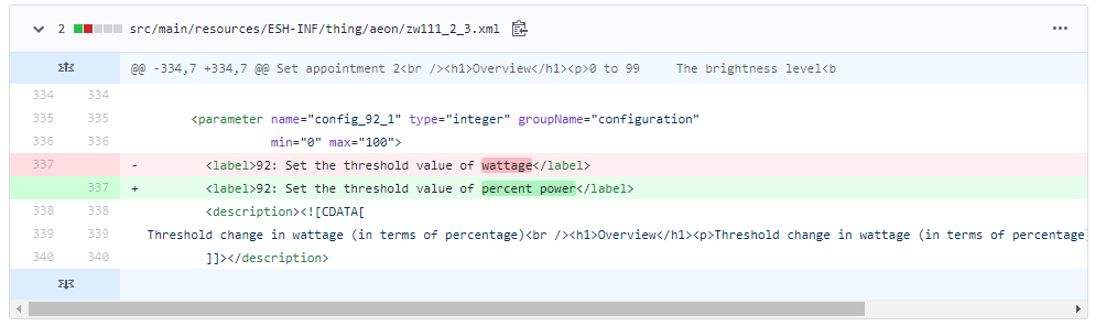

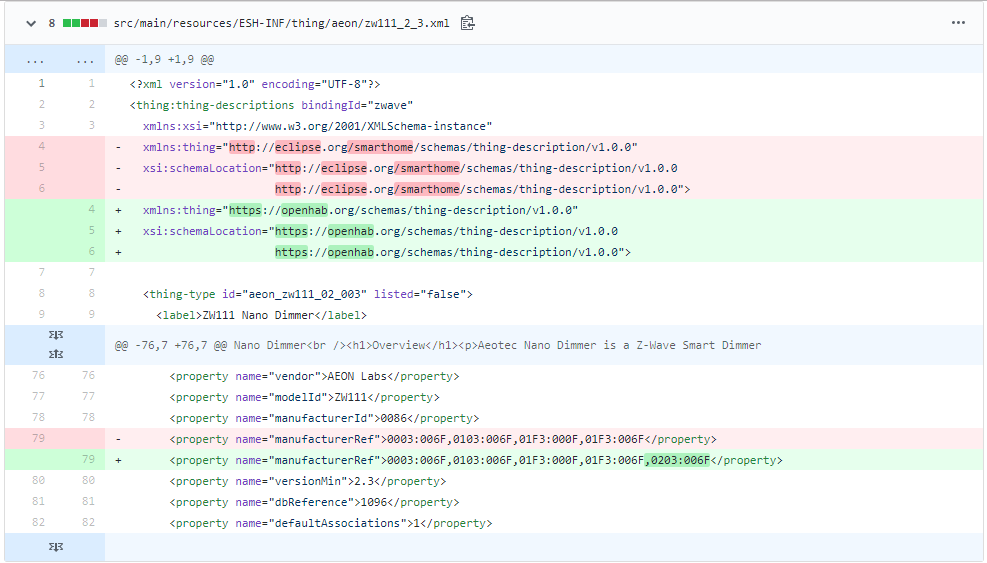

I just checked github, and the only change that has been made to this device in the past couple of months was 5 days ago when an additional type/ID was added.
Prior to that, a change was made in early October to change one of the labels -:
Even the original version of this device from September doesn’t have the switch channel included -:
