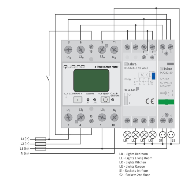

This Smart-Meter can switch the BICOM432-40-WM1 by IR-Interface.
But in OpenHAB i dont see a Switch-Item to do it…

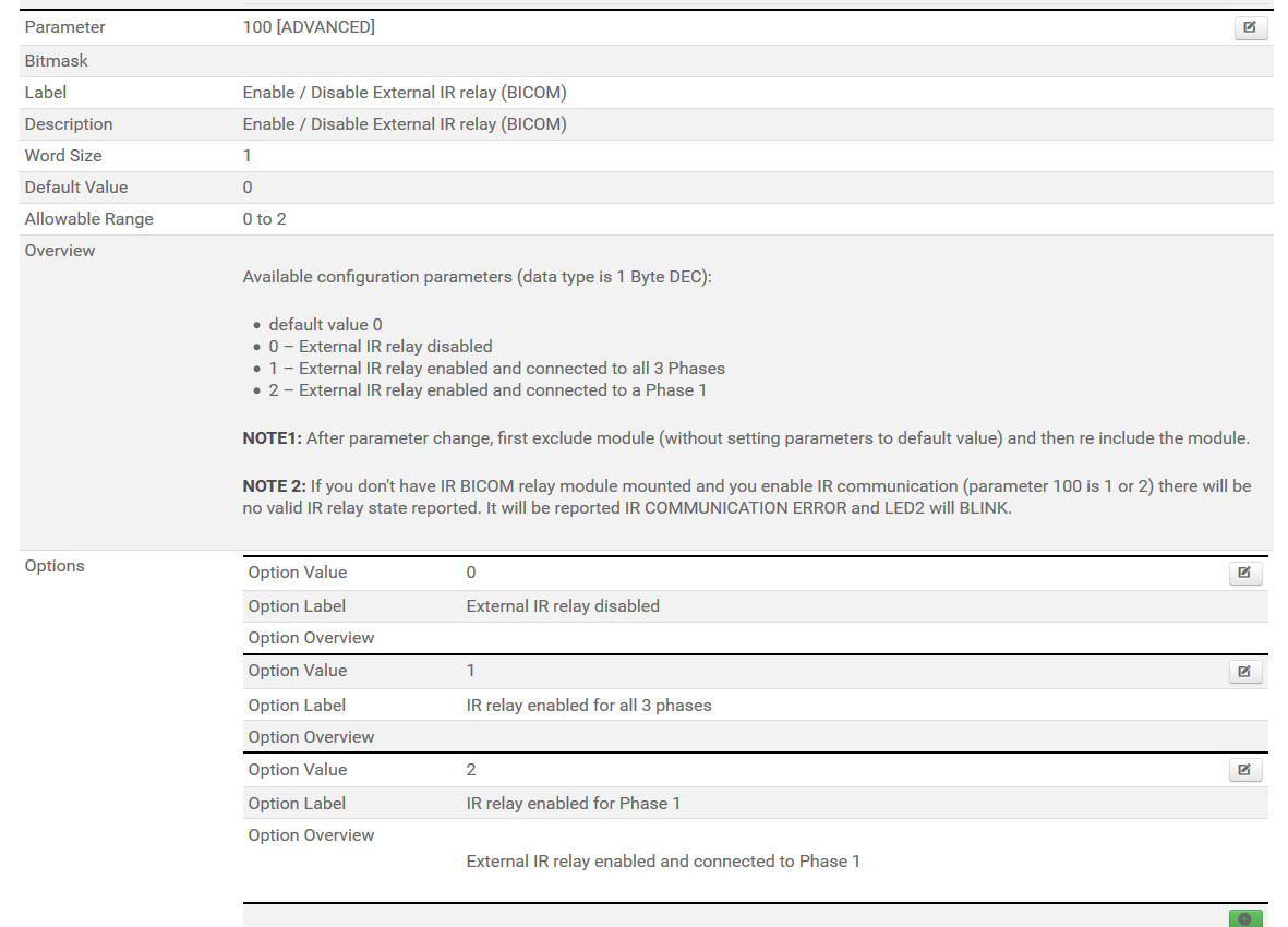

Okay, now I understand. I took a look at the manual:
By default, endpoint 3, which corresponds to
this relay, is hidden and can be enabled by changing the value of the configuration parameter
100
From what I understand, when the BICOM was added after your initial inclusion, the Qubino needs to be excluded and included again.
Then it should react as a slave on endpoint 3.
You definitely have to set config parameter 100 to the correct value:
