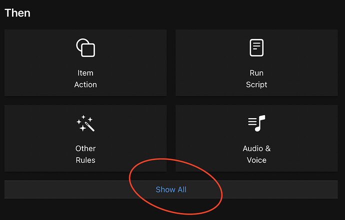

Thanks! Didn’t recognize, that you can not only use the 4 main categories for actions in Rules. Tried to work with “Item Action” and could not find my proxy item in the list presented.
Show more did the trick .. Works like a charm now!!
There is a check box to show Items that are not a part of the model.
