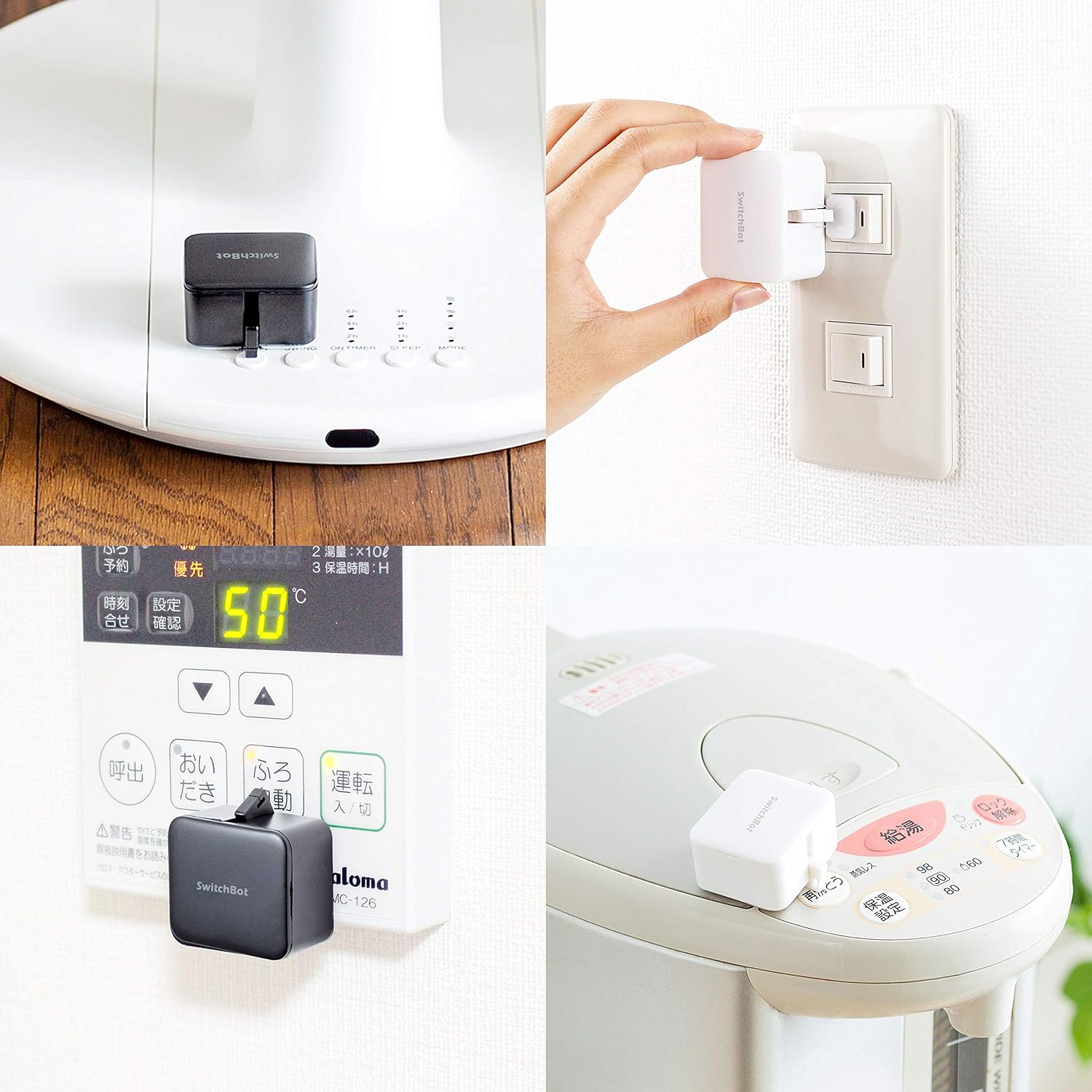

That can be a use case, or to activate/deactivate device with push button (fans, rice cookers, coffee machines, wall panel controls, etc.) have a look at these examples.

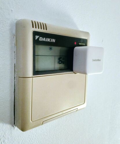

I just bought one of these at Prime Day for 17,50 €. See picture attached for my use case. I’m renting my flat and that Daikin air conditioner is a nightmare to program. Its thermostat doesn’t work either. Now I just turn the AC on and off from my phone and program it very easily with the Switchbot app. Of course, I’m hoping to integrate it on my OpenHAB installation and remove the proprietary app.
