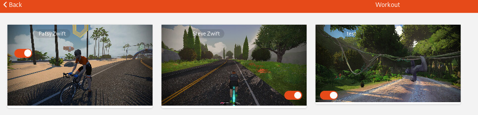

I’m trying to add config options to the widget for the horizontal and vertical position of the toggle and I don’t know how to reference the number that I input with the added “px”. It keeps placing the toggle at the top right edge off of the image.
- description: Horizontal position in pixels
label: Horizontal Position
required: true
type: TEXT
- description: Vertical position in pixels
label: Vertical Position
required: true
type: TEXT
Then I changed the oh-toggle to:
- component: oh-toggle
style:
position: absolute
top: =props.V-pos
left: =props.H-pos
But it doesn’t have the “px” that way. Also using “40px” in the input doesn’t seem to work either.
I also thought the input might be best to limit to numbers within a range but I’m not sure the proper syntax for that.
Well cancel that, I started over, changed a couple things and I can place the toggle easily anywhere I want now.
I did try to set a config option for the color of the toggle but it’s not working so far, the toggle remains orange which I assume is a default.

Current look of my test page that controls some outlets and light switches for our Zwift cycling workout setup.
