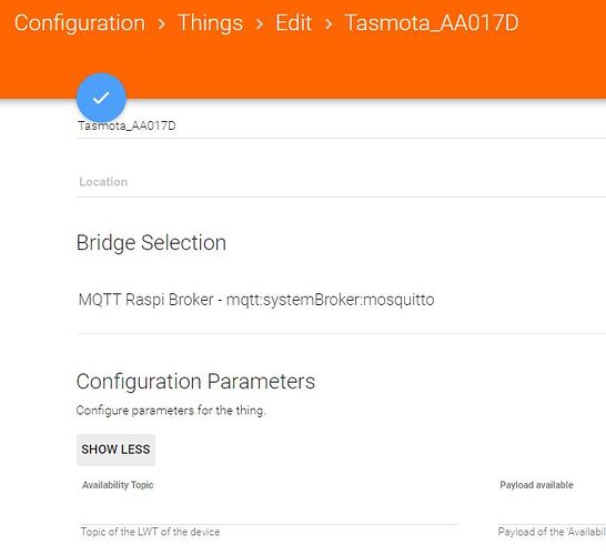

How did you setup your thing and item, and could you show those to us?
I used paper UI. Item was a simple switch

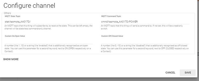

Thing is
For MQTT State Topic use: stat/tasmota_AA017D/POWER
For Custom On/Open Value use: ON
For Custom Off/Closed Value use: OFF

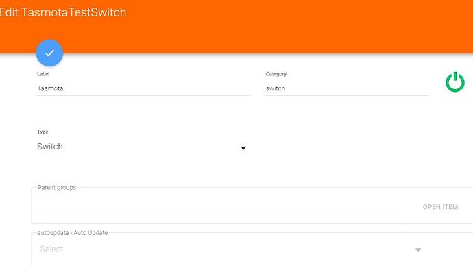

Then, I may have missed it, but nowhere in your Item screenshot does it show that you’ve connected it to this Tasmota Thing?
If you are using Mosquitto AND the systemBroker of openHAB you are using two MQTT brokers!
Your systemBroker Thing is not what you think it is, all.
It’s a bridge for cummunication between openHAB and the embedded (moquette) broker, for admin purposes, like broker settings.
It’s of no use at all for MQTT messages to/from external devices.
You may have named it mqtt:systemBroker:mosquitto but it has nothing to do with your actual mosquitto broker.
So in PaperUI, delete that Thing, uninstall the (misc) Embedded MQTT Broker if you have it
Start over by adding an MQTT Broker Thing to your MQTT binding, point that at your Mosquitto.
