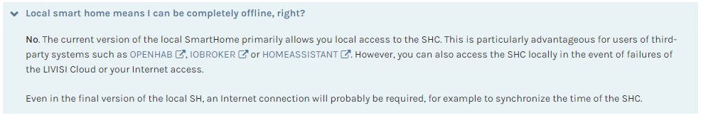

I did not try to block the SHC from the internet as Livisi currently doesn’t recommend to do so:
See
from the Livisi local SH FAQ
But the response times are much better on the local connection and as I also have sometimes Internet cuts at the vacation home, the connection should remain available.
