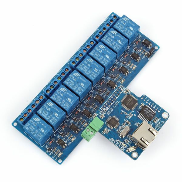

Hello I repeat my problem in english. I am a beginner and need help.
I have openhab2 installed on a Rasperry and would like to switch a Sainsamrt 8 relay (wlan module) with the Http binding. I have the binding installed this is my item
“Switch Relay1” [ON: POST: http: //192.168.1.4: 30000/01]> [OFF: POST: http: //192.168.1.4: 30000/00] “}”
These are the commands for the sainsmart I found in Inet.
"192.168.1.4/30000/00; Relay 01 off "
“” “/ 30000/01; relay-01 on”
And that is the entry in the log file
grafik
The relays can be switched via the Imatic app.
I searched in the Inet but unfortunately can not continue.
Thanks in advance for your tips.
@Luebbo
I searched again in internet and I found the following:
And there are the following information:
NOTE
SainSmart iMatic with RJ45 remote controll 8 channels WiFi relay model with the fixed IP of 192.168.1.4
IP of 192.168.1.4 only available in IMatic, can not be logged in through other browsers.
You must to modify the gateway address, AKA the router IP address, to be 192.168.1.1
@Luebbo
Which model do you have?
a) 8/16-Ch Relay (SKU: 101-70-C03-01) 8/16-Ch
or
b) 8-Ch Relay (SKU: 101-70-C00) 8-Ch
Controling via browser or with other software is only possible with: 8/16-Ch (SKU: 101-70-C03-01), this has an integrated web server.
I have the relay for 8, that means that I can not control anything with openhab.
Thank you for your effort and support and a merry Christmas
That’s a pity. Merry Christmas, too. :slight_smile:
