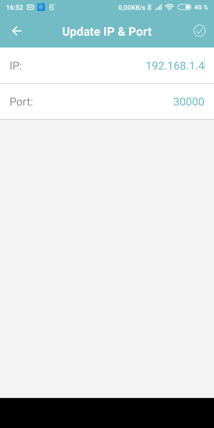

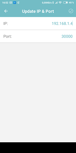

Settings of My imatic App from sainsmart

Ok. When you open http://192.168.1.4:30000 with a browser on your smartphone, what do you get?

hallo the same. network timeout
i made a pingtest ist works at 192.1.168.4
