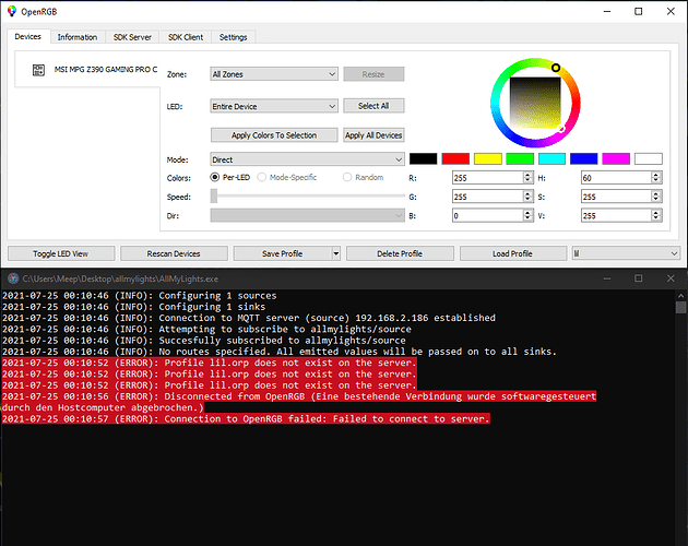

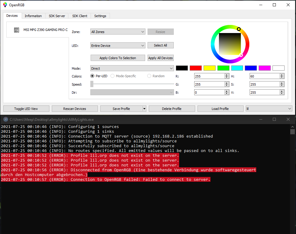

So Sorry i didnt had Time till now to Test it i tryed it today but i run in to an Problem.
I configured The allmylightsrc with my mqtt Server and the Open RGB Server that worked.
When i send an Profile name it says that Profile doesnt exist.
But it exist also when i stop the Open RGB Server it gives me an error that is off now so i guess iam connected in the right way.
Can it be a Problem that i use the newest Open RGB Version.
You may got an idea what iam doing wrong?
orgb
Could you invoke allmylights with --info and provide the output? Also the exact commit your OpenRGB was built from would help. You can find it under Information -> Software -> Git Commit ID

orgbgit
It finds the Profiles, i send for example “red.orp” via mqtt is that the right format when the profile name is “red” ?
Yeah, you’re using it the right way. I have to look into it to figure out what’s happening :thinking:
Idk for which Version you where coding your Software, but i remember older open rgb Versions where saving Profiles in the Location from where it was started. This Version now saves it
\Users"username"\AppData\Roaming\OpenRGB
May this is a reason for it?
I just went through the OpenRGB commit history and they changed a few things regarding the profile management (in particular they do no longer include the .orp extension in the profile list returned from the server and they also expect the profile name to be provided without the .orp extension edit: their profile loading code seems to be dealing with both cases just fine - with or without extension) Working on a fix (will be a quick one, an hour max) Will get back to you once finished :wink:
I released a fix here that I cannot validate with an actual OpenRGB instance at the moment because I am moving apartments and my desktop computer is out of order. I basically worked off the changes I’ve noticed in the OpenRGB code and hope it works.
Nice! Works Great now Thx a lot for the fast help :smiley:
