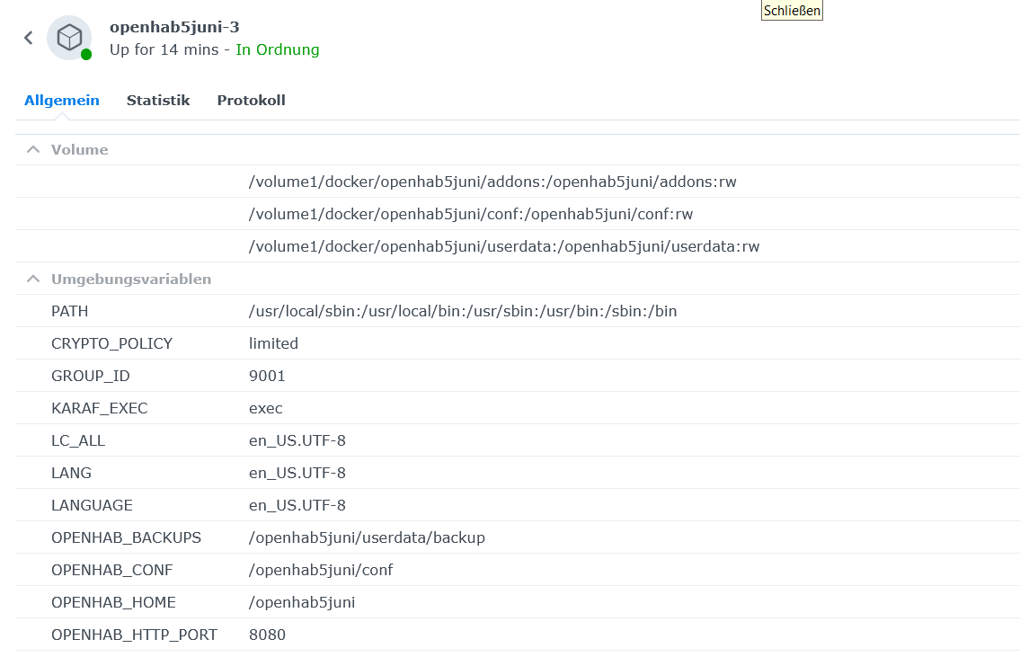

Today i stopped my OH4 container, created a new OH 5.0.0 M2 container and finished the installation ( which lead to a initial start of OH5 )
After the installation I copied the folder addons, conf and userdata from the stopped OH4 container into the folder of the OH5 container.
After starting the container OH 5 starts with the initial offer to create a new administrator account. Unfortunately no configuration of my OH4 version loaded.

I think i keep on making a mistake by mounting the right path
eg.
my new fersion is located at openhab5juni.
the mapping of all possible pathes looks like this
but when i start the container the first time the installtion makes no update to 5.0.0 and OH is not on at port 8080
the file update.log doesnt exist in userdata/log
Then it’s not updating or you are not actually running the 5 image. Did you look at the file I pointed out above to confirm you are running a container from the 5 image?
That file doesn’t change, it’s what the container copies from when it upgrades. That will tell you what image you are using.
