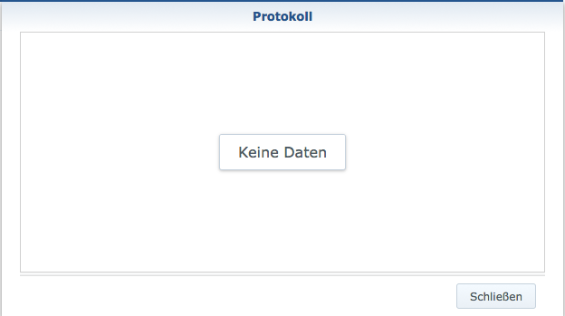

first of all thanks a lot for this package and the effort you’ve spent on it! I love it :slight_smile:
I’ve installed it, migrated my /conf files and basically all worked fine instantly.
The only cumbersome issue I face, is that the logs stay empty completely, displaying “No Data” in the Packet Center.
I’ve given the Openhab2:Users read/write access to /volume1/@appstore/openHAB2/userdata/logs$ but this didn’t have any effect.
I’m running
DSM 6.1.3-15152 Update 6 (this issue was present in Update 4 & 5 before) on a DS716+II with 2.2.0-007-SNAPSHOT installed on it.
May I please ask your support what to do to get the logs filled?
thanks in advance,
Kurt
hi Kurt,
I’m running the same snapshot and the logging is working OK. (that’s with DSM 6.1.3-15152 Update 6 on a DS214play).
I’ve just noticed you say “Openhab2:Users”, but on my system it’s ‘openhab2:users’. Might that be it?
Thanks for your swift reply, but it’s actually owned by openhab2:users
I still get an empty logfile
does the log files exist at
/volume1/@appstore/openHAB2/userdata/logs/openhab.log
That’s where the package centre will be reading the log file from.
the file itself is there, but it’s not being populated, having 0bytes in size.
that’s why I initially thought it’s just lacking r/w of the openhab2 user - but this seems not to be the root cause.
Kurt
that’s reached the limit of my knowledge then, sorry.
The only idea I can suggest is stopping OH, deleting the log file and then restarting OH.
