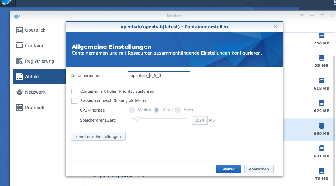

Downloading is fine (as it should be). When creating a new container I chose the default values without touching anything. Vanilla, you could say. Starting the container is fine until the web interface seems to be prepared.

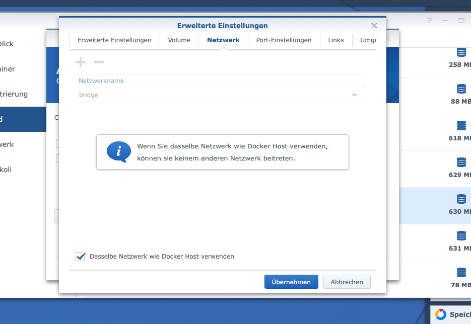

Perhaps there’s something wrong with your DNS?
According to your logging dl.bintray.com is an unknown host:
Caused by: java.net.UnknownHostException: dl.bintray.com

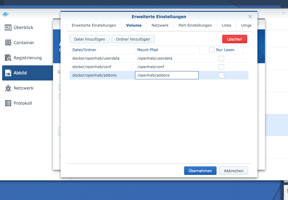

Very Basic Config via Docker Synology UI
