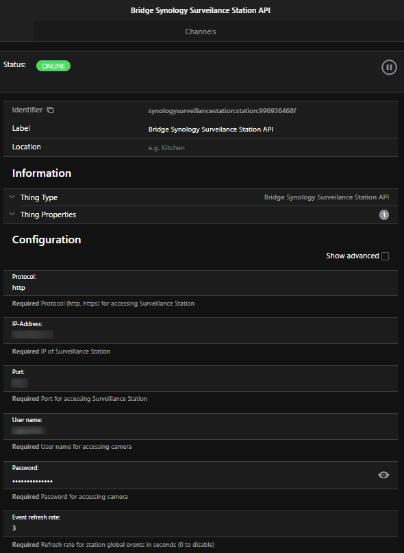

This is the bridge after setting it:

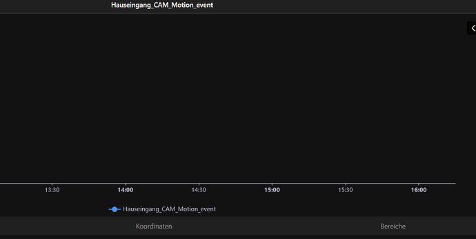

Hey Pav, i got an new issue it seems that i am not receiving motion events, i see they are triggerd on the Synology but the motion item has no changes.
Which infos you need to analyze this problem.
grafik
Regards
Simon

Hi, thanks for your reply.
belive it or not, after i posted this thread i have received an motion event… i will keep an eve on that again, and nothing changed.
Regards
