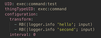

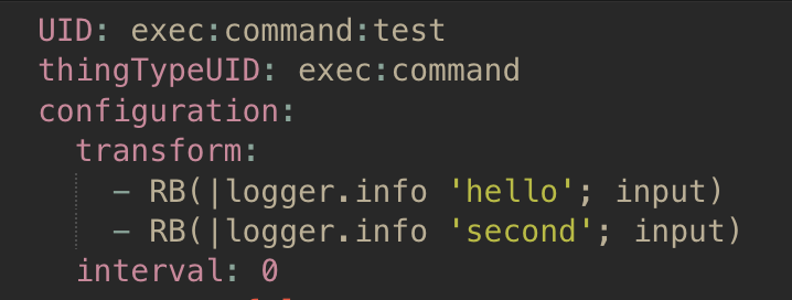

Chaining in the UI Code Tab:

Chaining in a JRuby script
things.build do
  thing "exec:command:test",
        config: {
          command: "/bin/sh -c 'ls -al /*'",
          transform: ["RB(|logger.info 'hello'; input)", "RB(|logger.info 'second'; input)"]

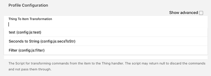

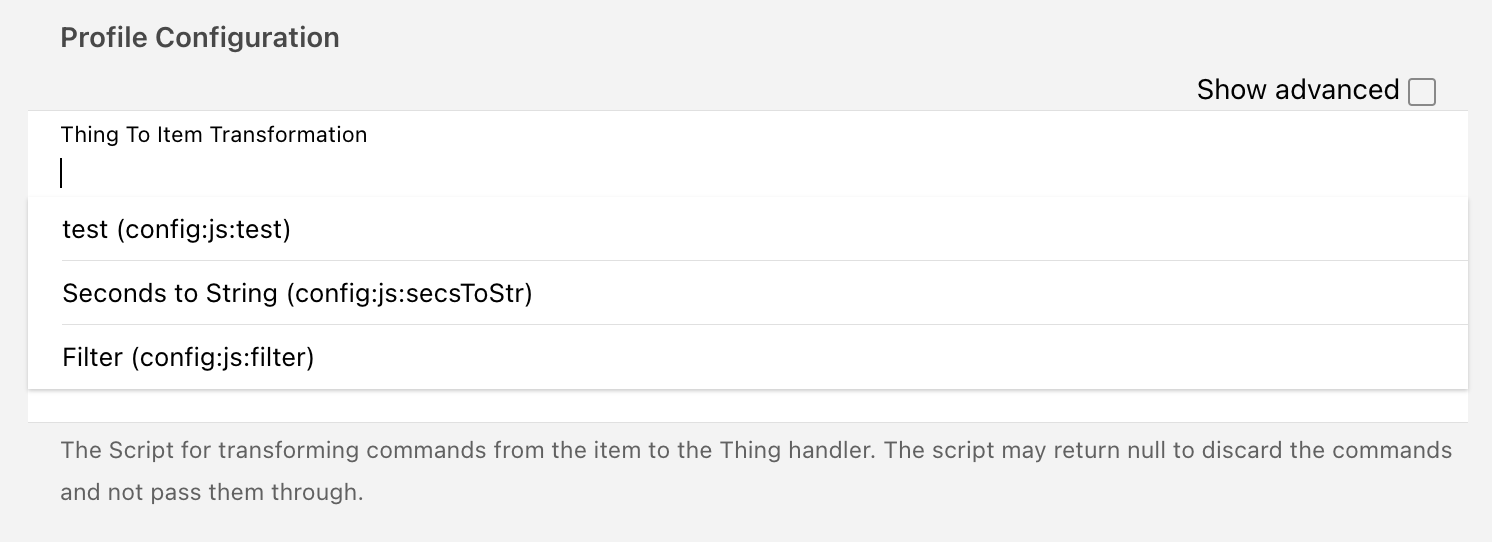

@jimtng Since you contributed the SCRIPT profiles: Do you have an idea why the config description for profile:transform:JS does not list the available scripts as options for the stateFromItemScript und commandFromItemScript?
There was never one, afaik, for any of the parameters.
toItemScript and toHandlerScript list the available scripts as options and I haven’t found where this is done yet.
It was hiding in the TransformationService! Add missing ScriptProfile parameter options by jimtng · Pull Request #4360 · openhab/openhab-core · GitHub
@Larsen fyi
