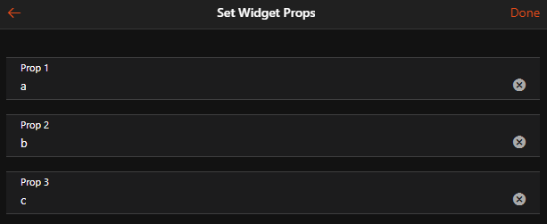

uid: widget_116204d47c
props:
  parameterGroups: []
  parameters:
    - name: prop_1
      label: Prop 1
      type: TEXT
    - name: prop_2
      label: Prop 2
      type: TEXT
    - name: prop_3
      label: Prop 3
      type: TEXT
tags: []
component: f7-card
  title: '=JSON.stringify(props)'
  default:
    - component: oh-repeater
        for: i
        sourceType: range
        rangeStart: 1
        rangeStop: 3
        default:
          - component: oh-button
              text: =props['prop_' + loop.i]
